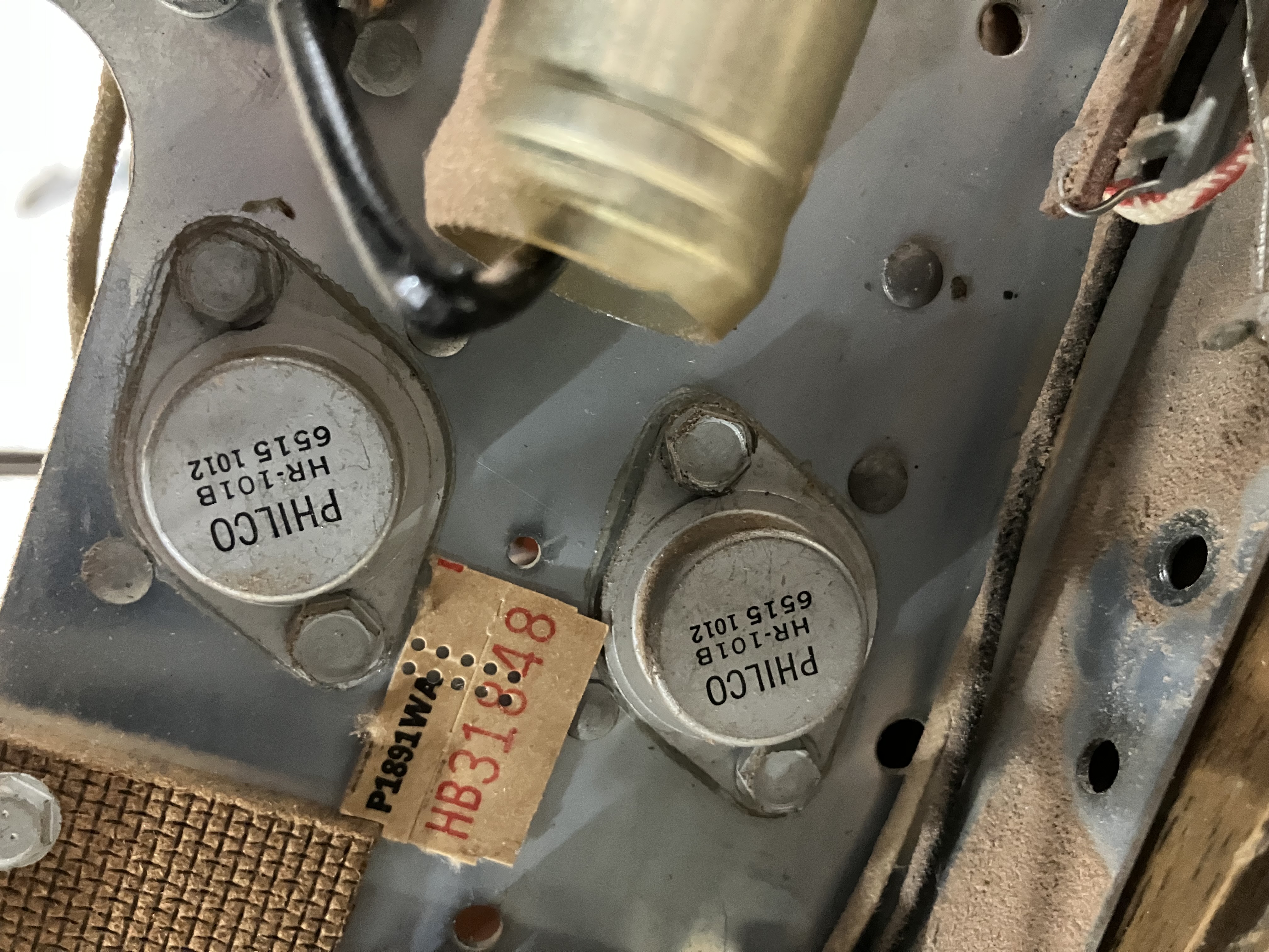

If so, how do I know if my output transistors are “NPN” or”PNP”? They are labeled philco HR101B 6515 1012. And what is a good way to insulate the base of them back to the heat sink? Also, they just pull out, the leads are not soldered to anything. Problem? Or normal?

Thanks RodB and morzh, Am I using incorrect terminology regarding output transistor question whether they’re NPN or PNP? Seems to be different testing methods for each type.
Capacitors…. Cross reference for replacement capacitors, especially the large one is beginning to frustrate the heck out of me! Inernet search for comparable output transistors has yielded nothing useful to me. It could be so simple until it’s not.
Hi Jeffcon, your HR-101 transistors cross reference over to an ECG-104 or RCA SK 3719 or an NTE104. It’s a PNP Ge (germanium) power output transistor!

Testing transistors is simple and is best done with an analog ohmmeter.
If it is a PNP, then:
- Unsolder two wires that are not connected to the case (the pins). In case all three terminals are insulated pins, unsoder any two.
- Locate the terminals designations: E, B and C.
- Set the Ohmmeter to "x1"
- With Negative lead (Negative does not necessarily mean black or Common: on old analog meters Common may carry positive when used as Ohmmeter; you could determin this with another voltmeter) on B, touch the Positive lead to C and E. There should be finite value of tens to hundreds Ohm measured in both cases.
- Switch Ohmmeter to x100
- Now reverse the polarity: connect Positive to B, and touch Negative to C and E. There should be no needle movement at all. The BE and BC junctions should be fully open.
- With the Ohmmeter set at the same range, touch CE with the leads, first one way, and then in reverse.
There should also be no needle movement.
Note. Make sure your hands to not touch probes' tips at any time - otherwise you will see some conducting when you should not.
Any of these not met, the transistor should be replaced.
Note: this does not test for "Beta". This is usually not necessary as transistors that have their junctions intact do not deteriorate much over time. If however you decide test for the "Beta", you need a specialized Multimeter with a socket and switch position made for it.
The static Beta could easily be measured with a couple of resistors, a potentiometer and a couple of batteries, but as I said, in your case it is likely not needed.
If however the transistors (or one of them) are bad, it then makes sense to buy a pair and replace both.
The transistors do not have to be matched well, as if both are PNP, then one will work as a follower and one as a CE (unless using a transformer push-pull arrangement which it is likely not). However making sure both have a good Beta makes sense.
You probably don't have to worry about replacing transistors until you finish the recap. If you find that a transistor should be replaced it must be replaced with the same type, either PNP or NPN. Like Ron noted above, you will have to purchase a substitute, as your original is no longer made. That's where caution should be used. You'll find several equivalent replacements and maybe several "close" replacements that may work.

The output transistors are in sockets. Removing and replacing them may help "clean" the contacts. Transistors have 3 elements- the Emitter, the equivalent of a tube's cathode, the Base, the equivalent of the grid, and he Collector, the equivalent of the plate. This is an oversimplification, but it works. In a "TO3" cased transistor, like your output transistors, the case is the collector connection and this is above chassis ground. Therefore the mica insulator or its equivalent must be in place, and both sides of the insulator must be coated with heat conductive electrically insulating grease, available from many sources on the internet.

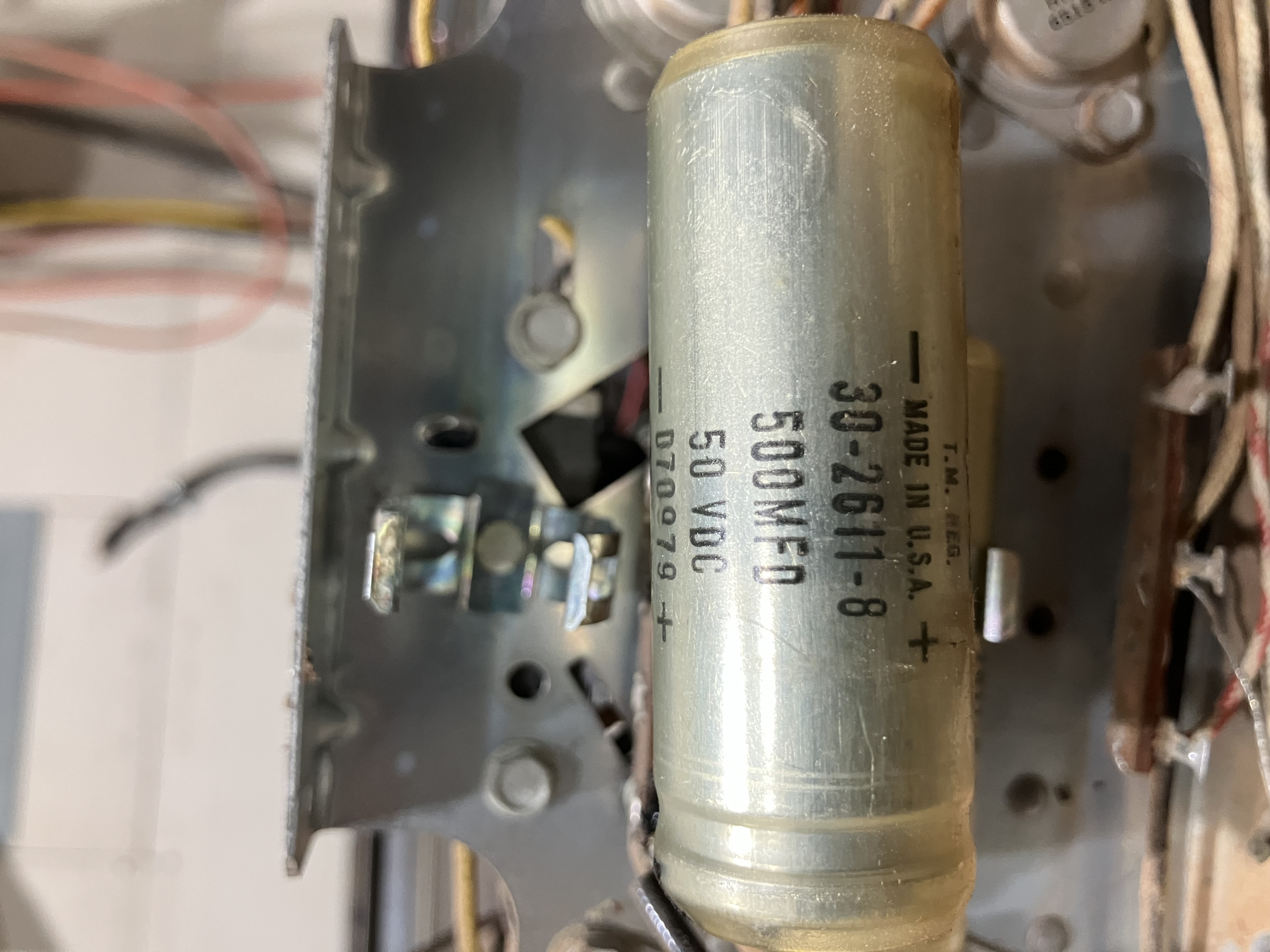

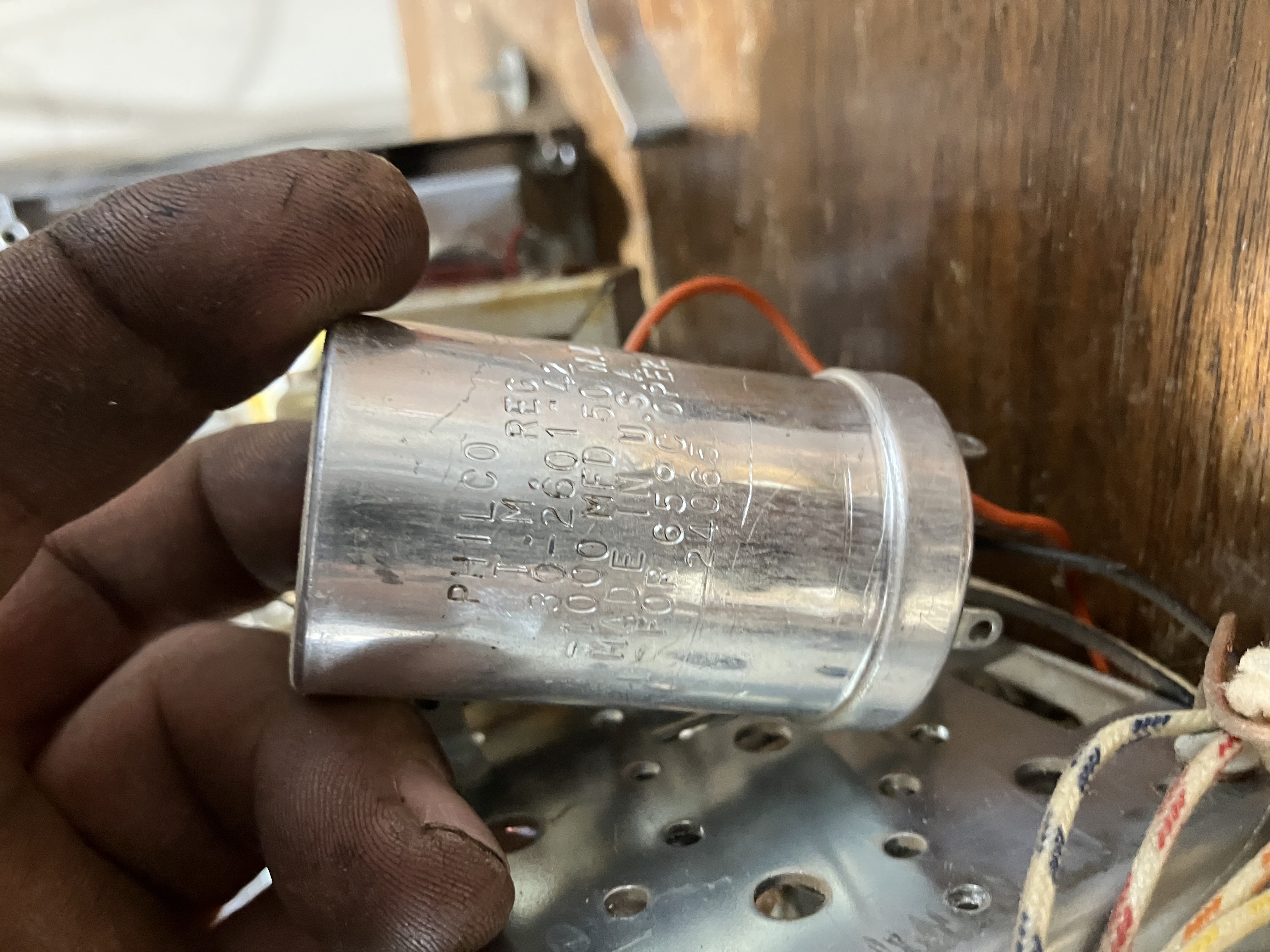

Well, I've been stumped at trying to get the first of 11 electrolytic capacitors. I got a schematic and have a list of the electrolytic caps and cannot find a match.
Like I've stated earlier, I'm a newbie and am slowly learning. I've procured  desoldering and a soldering irons and have been practicing on old pcb's.
Now with my new skills I feel confident in ordering parts. If my computer had a toilet flush sound effect for every failure trying to find this 1000 cap. 50v 65deg.Celsius chassis mount tab capacitor my wife would think i had the flu! I have a pic of it in my initial post above. I'm not fluent enough to translate that info to other types. I found a 1000 50v through hole cap that looks tiny comparatively but have no idea if it would work. The list of Electrolytic caps I am figuring i need as a start to recapping is in the attachment schematic. If anyone has any input on which ones are priority and if there is any cross reference for part numbers or just plain "This is what you need" I'd appreciate the input!

Hello Jeff ,
Far as the Electrolytic capacitors go here is a list of parts.
that will work . I like using Nichicon and Panasonic capacitors and I buy from mouser electronics or digi-Key
value
C1- 1000ufd ,50volt same UHE1H102MHD3TN , 647-UHE1H102MHD3TN
C2- 150ufd, 25 volt 50volt UHE1H151MPD, 647-UHE1H151MPD
C3,C4,C5 - 5ufd,25 volt 50 volt EEU-EB1H4R7SB, 667-EEU-EB1H4R7SB
C6,C9 100ufd, 3 volt 10volt EEU-FR1A101, 667-EEU-FR1A101
C8,C11 50ufd ,25volt ECE-A1EN101U, 667-ECE-A1EN101U
far as C8,C11 make sure you use Bi-Polar/Non-Polar Electrolytic Capacitors
this list of parts will make good replacements for your stereo .

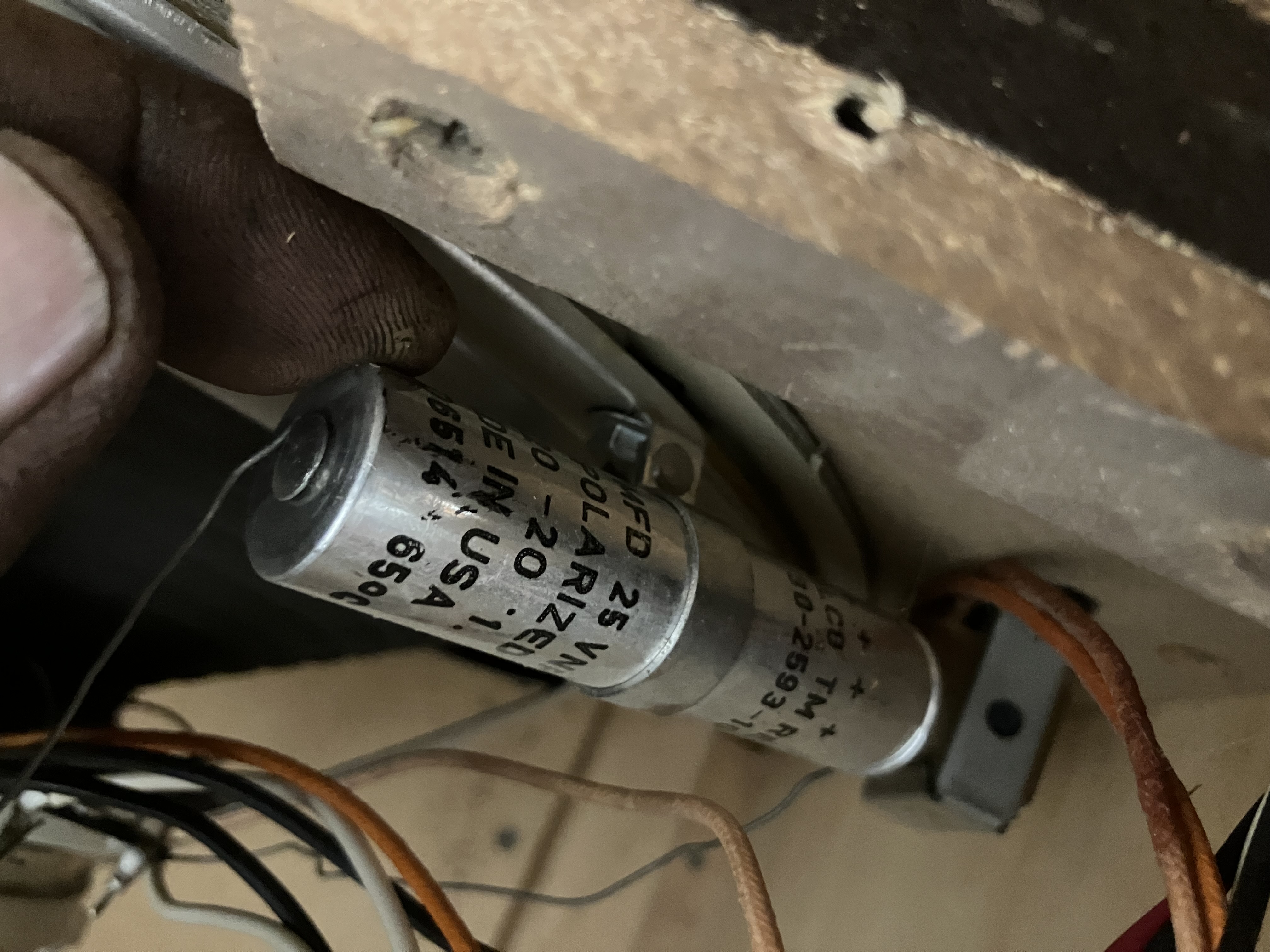

Thanks Radiorich! I ordered and received the capacitors you so kindly laid out part numbers for. I am unsure about C-8,C-11,C-6,and C-9. The part number you gave for 8 and 11 is 100uf 25V. The schematic I have says 50uf 25VNP is what’s there. Will 100uf 25V work?
Also, 6 and 9 part numbers you gave are labeled
10VDC 100uf. Not sure about the 10VDC portion of the description since no other capacitors I ordered have VDC in description. Please let me know if I’m being overly cautious or point a direction I could go
