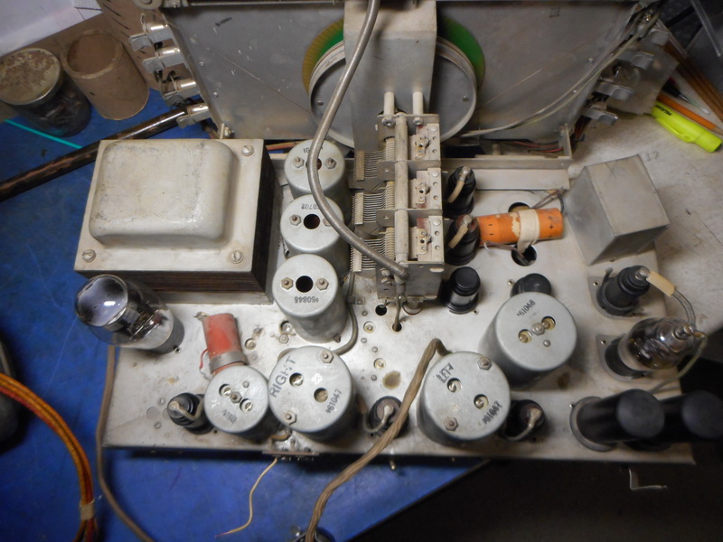

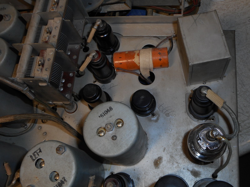

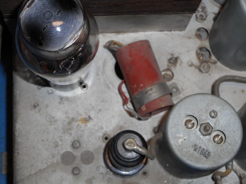

This Marconi was a bit of a challenge. It was totally missing one electrolytic  capacitor, and the photos show a couple of others taped [with hospital tape]
to the top of the chassis, with bare wires.

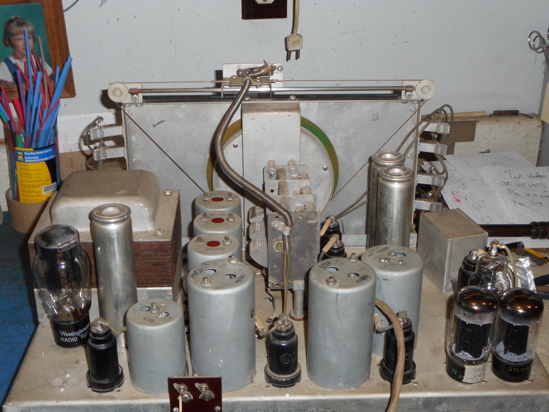

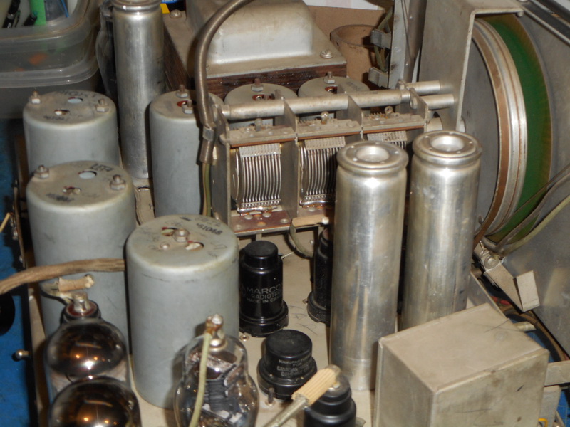

I had to rewire in the missing cap, and recap the radio.
   After going through everything and getting it fixed it does play very well.

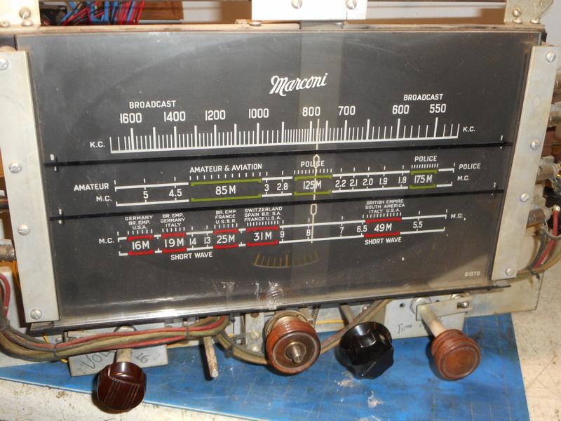

 I had to take out the glass [four pieces] and clean them..
I had a junker Marconi  with tall cans  and they fit perfectly in the holes in the chassis where the original cans were

  I have a fellow turning me a knob to match the others..
