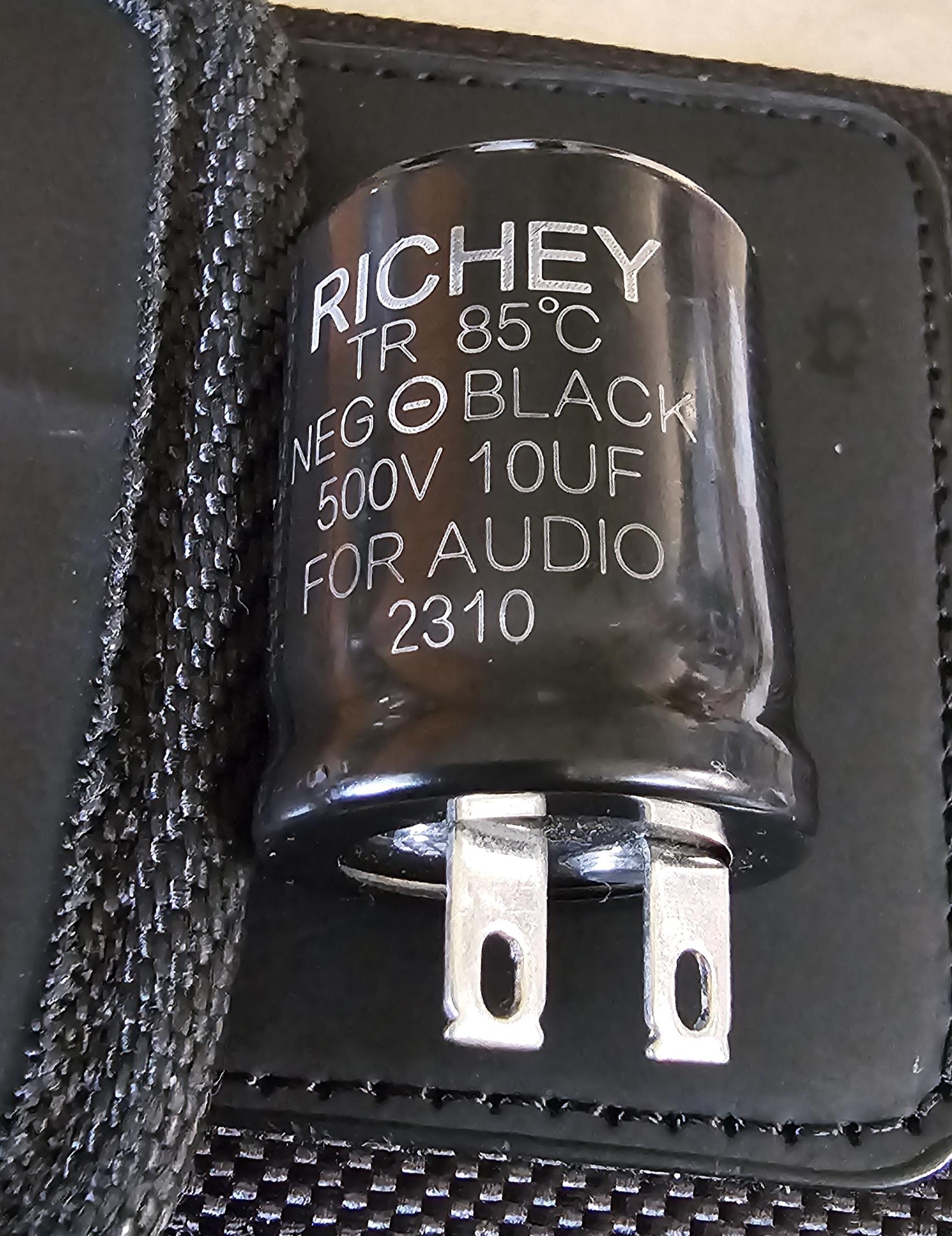

Hello guys I ordered and received a capacitor from just radios and can't figure out which side is the pos/neg terminal. There is writing on it that says "Neg-Black" and also 1 terminal is knurled. I am attaching pictures of it and hopefully someone can help. PS looking at the writing on the side it's mostly to the knurled terminal. But I don't know which is which.Thanks
#35
Hello Osanders,
I even looked that product up on just radio they must have secret design .
I can't find a part number on their site not even on Richey's site Digi-key had just radio selling it on their site and I did find part number but even on the poor data sheet it did not show .
that why I like Nichicon or Chem con from mouser .
maybe some welse knows .
#36
Thank you Radiorich unless someone else chimes in I will try and message Just Radios and hopefully they will have an answer.
