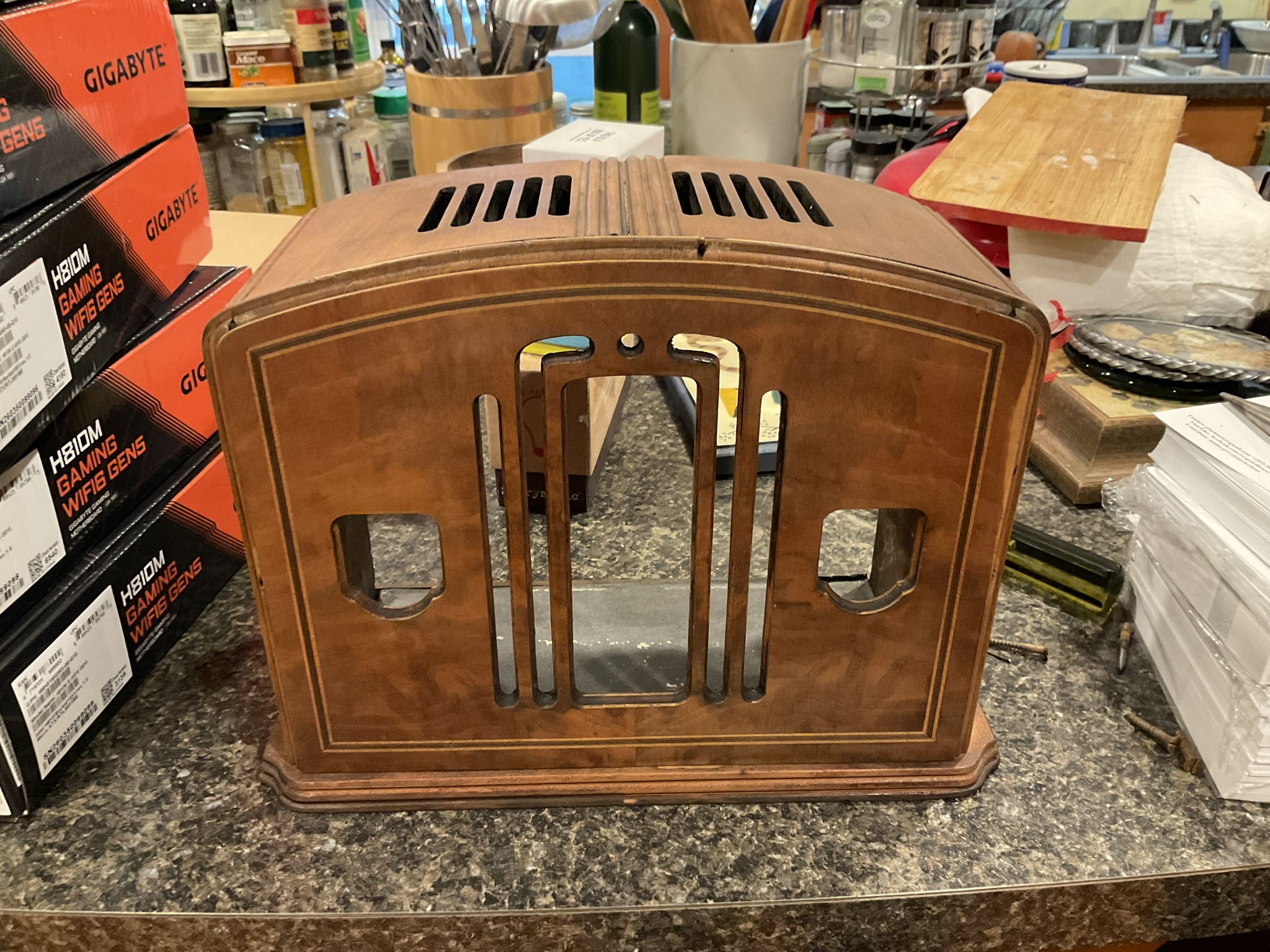

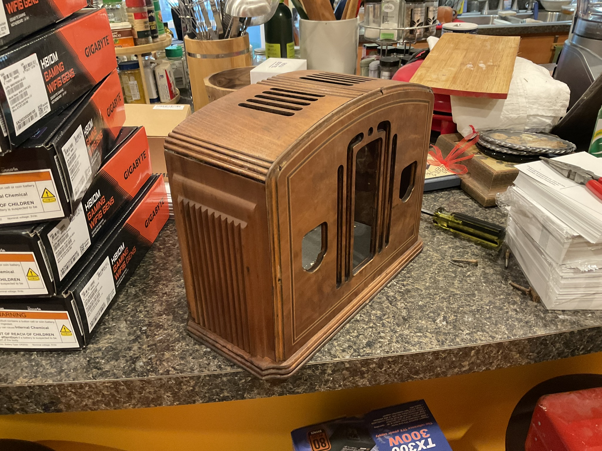

I started stripping this cabinet before it got super chilly out because I knew I wasn't going to be able to work on it too much this winter.  I'm just starting this thread now since I just posted about the electronic restoration in the other forum and the symmetry of doing so soothes my borderline neurodivergent brain.

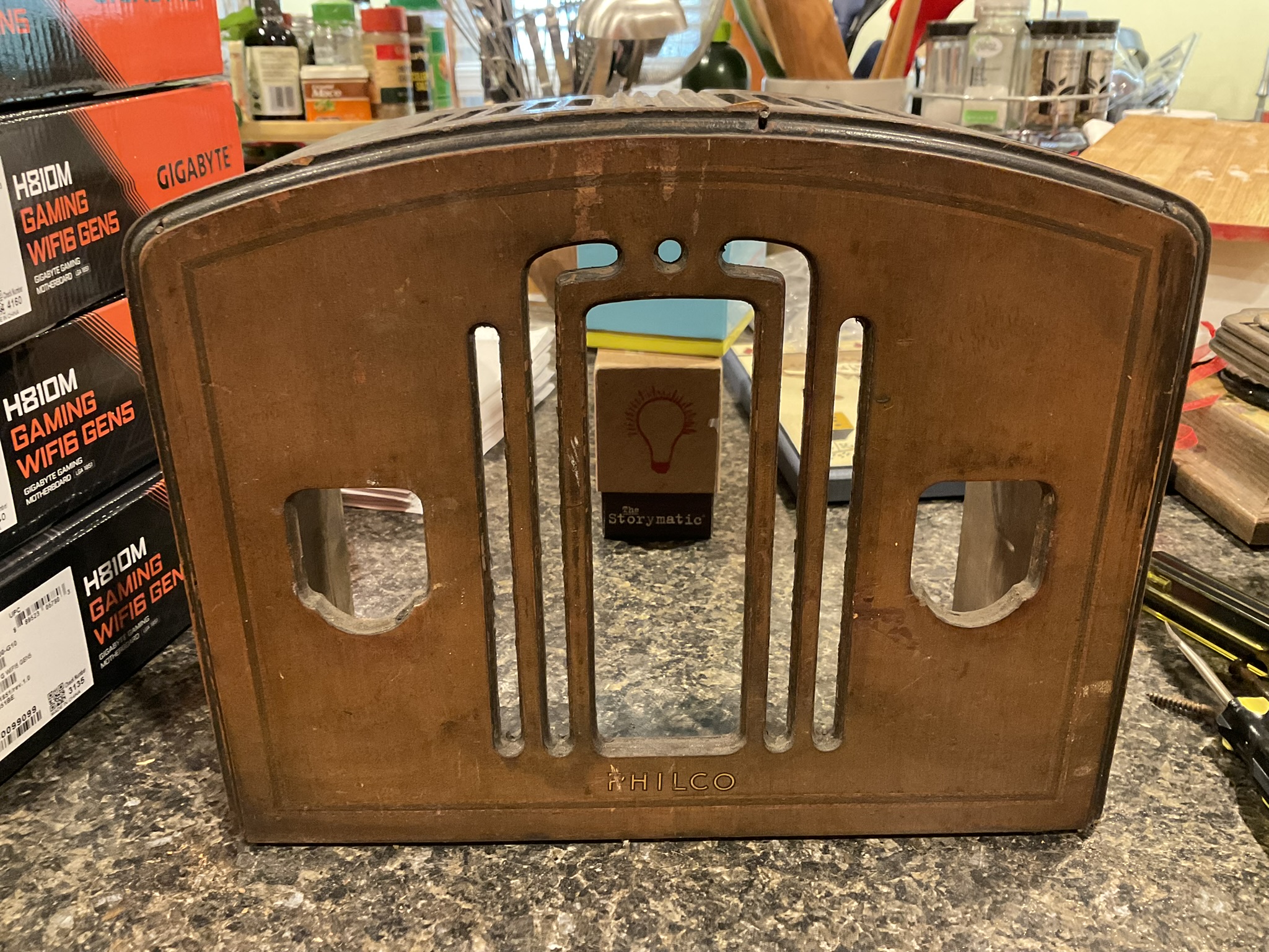

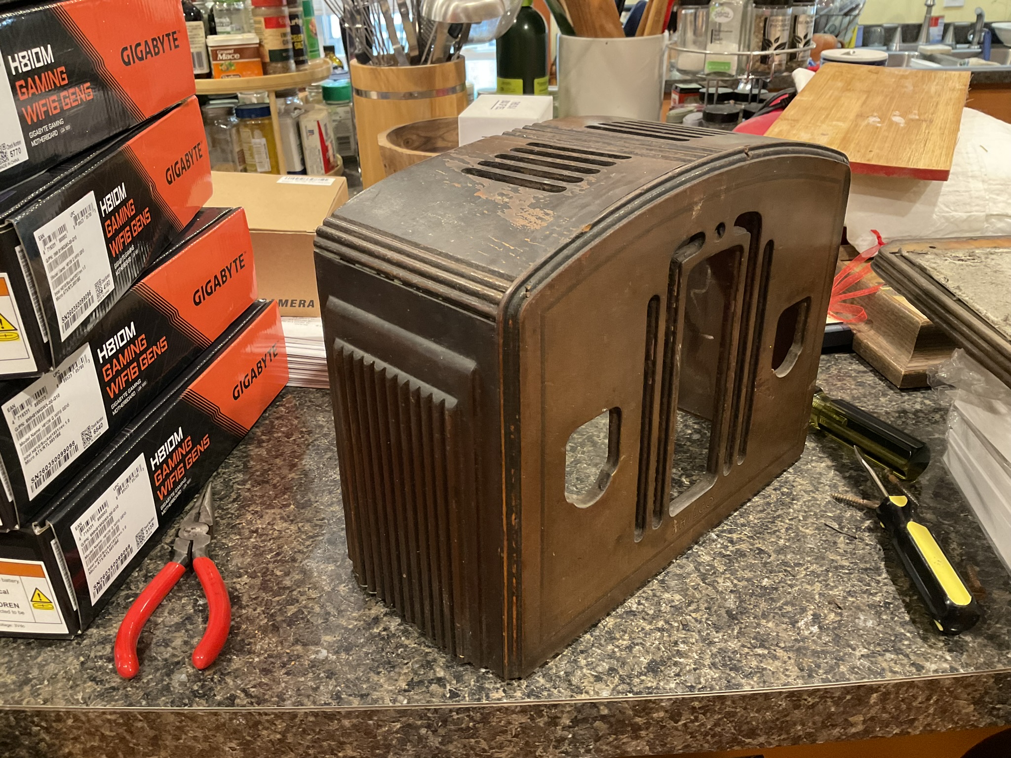

Someone had definitely been over this cabinet with another coat of something that didn't like coming off but acetone and lacquer thinner mix eventually did a pretty good job.  Lots of added glue in here too.  At some point, someone used some finish nails to keep or reinforce the joining of the face to the front and sides.  Not crazy about it and will probably try to seat them a little better rather than have to patch empty holes.
Front is in pretty good condition, all things considered.  Will need a little touch-up with stain on the right side of the photo, but ultimately I think I'll just go over the front with clear gloss.  Will do some dark on the sides and grooves up around the top for some contrast.  Same for the base, I think.
