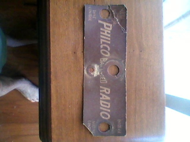

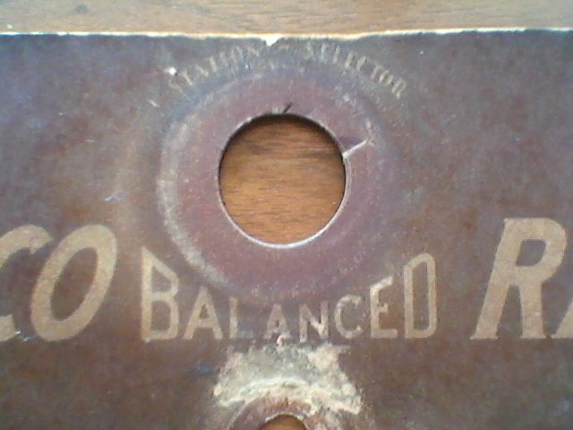

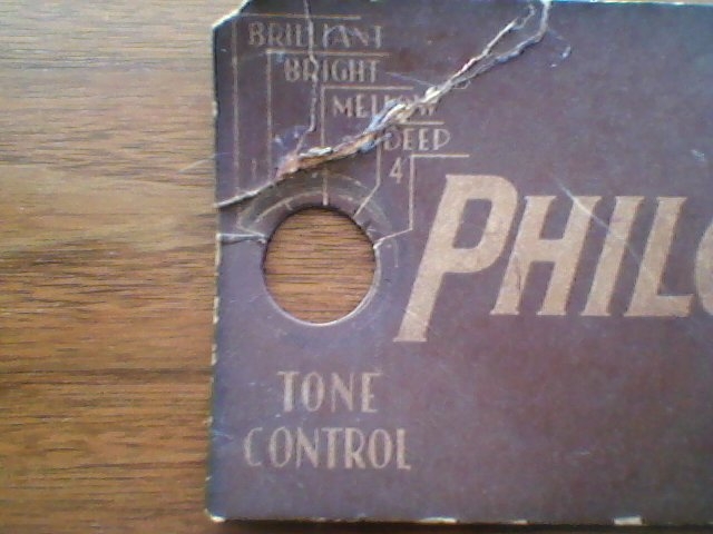

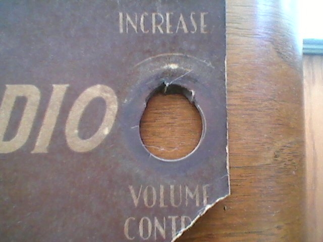

                On my Philco 111 there was a cardboard overlay over the controls that listed what the controls were. I believe that this was something included by the factory, and was usually discarded by the owner soon after they brought their set home.
Attached are some photos of it.
