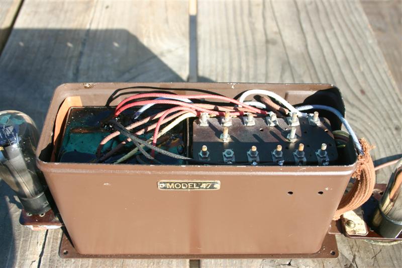

Besides new caps it is also nice to have all new wire in that PS rather than the crispy stuff that is in there now. I have rebuilt and rewired 40 (3) 42, 44,45, 46, and a 47 all are a little different. Some models have 2 or more different PS. Figure out which one you have before you start.
I later mixed up a batch of paint that was a much better match to the original. This 47 is one of the hardest to do.
