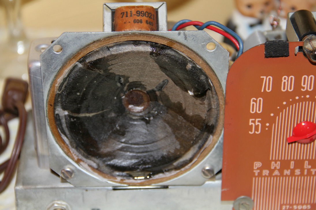

One other complicating factor. Although the radio was purchased in about 2 months ago, I only had the opportunity to open it up the other day. I discovered that the speaker cone had been ripped during shipping. I repaired the cone using a techique found on this forum using glue and tea bags and the result is also shown.
I also have not checked to see if any tubes are weak.
Now the problem. I can tune stations in, but they are not sharp. Now to me if this were a "speaker" problem (because of the repaired cone), I would expect buzzing but not a lack of sharpness.

Upon the suggestion of Jeff from Radiotiques I also tested to see if the repaired speaker was a problem. So I desoldered connections used aligator clips and tested using the speaker on a "junk" Philco 47-204. The sound was very good. This is where I have stopped.
I still need to remove a loop and adjust the trimmer for max volume, so that the screw is in the middle of the range. I also need to see if I can easily remove the speaker from the 47-204. I also don't know if this speaker will fit in the 48-200 case.
Lots of unknows, but I am making some progress.....
I have managed to remove the speaker from my "junk" 47-204. The speakers look to be the same size with one exception. The speaker from the 47-204 mounts via a bracket to the top of the chassis. (see picture).
The speaker on the 48-200 mounts via 2 screws at the front of the speaker. I am not sure if this speaker will fit in the 48-200 because of the bottom bracket. It looks like it is welded or soldered on. Does any one know a safe way of removing the bottom bracket in case I need to [without damaging the speaker]
Also the 47-200 speaker was connected to the radio via 3 wires. Positive and Negative, and then a 3rd wire as shown in the photo. What is this extra wire ? Another ground ( ???? )
The speaker on the 48-200 only seems to have 2 wires, though I will check when I take the damaged speaker out. Anyone have a suggestion as to what to do with the 3rd wire ?
Lastly a question. Since it seems like the distortion was caused by the torn [and then "fixed"] speaker. Is it possible that the speaker would be OK after a period of time, and that it is "stiff" because the glue and tea bags that I used for the repair ? Would it losen up if it were played for a while and sound better ? I am just curious if anyone has any experience in this area ?

Well it turns out that the speaker on the 48-200 was attached by a home brewed method of using the 2 screw holes at the bottom of the speaker, with non philco supplied brackets.
I looked back at a photo of a 48-200 that I restored and gave away for christmas and the speaker is not attached that way.
There are holes in the 48-200 chassis for the bracket on the 47-204 speaker and it fits like a glove. So that problem is solved.
The final issue I have is that 3rd GREEN wire which was attached to the chassis on the 47-204 at 1 end and to an inner connection point near the cone on the speaker.
Q: should I attache this green wire the same way it was connected on the 47-204 ?????

New speaker is in the 48-200 and the red and blue wires have been resodered and shrink wrap tubing was applied.
I still have the green wire issue. The photo shows that the green wire goes to different place on the speaker than the red and blue wire.
I did not notice this before, but there is a cut off green wire on the 48-200 leading to somewhere in the chassis, but I am not sure where.
Logic would seem that I should just connect the two green wires together and problem solved. But I would like to know what the green wire is for and what it should actually connect to.
Additionally, the radio is working great. Nice and clear voices, sound, music and very easy to tune. The home made antenna (now off the cardboard) works well and is ready to be attached to the inside of the case.
