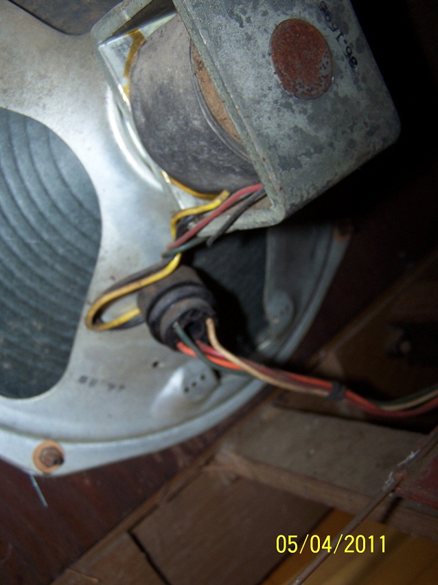

I am in the process of restoring a 47-1230 console for my friend and neighbor....this was her grandfathers radio. The speaker wires were broken loose from the electrodynamic speaker and I can not find any diagram etc in the schematics indicating the proper reattachment of the wires...I might be able to figure this out but want to make sure. Wires coming from the chassis are green, white, red and orange and there are five holes in the plug and four pins on the speaker. The five holes on the plug are all numbered 1-5 so if someone can tell me how to mate color to number I think that I will be set. the rest of the elctronic work has been completed....thanks for any help....victor

Do you have the schematic of this set? If so, you will have no choice but to trace each wire from its source inside the radio to find where each wire connects on the speaker.
Only four pins are used. About all I can tell you is that the two closest together go to the field coil, and the two farthest apart go to the speaker voice coil.
Unless someone who owns a 1946 or 1947 Philco console chimes in...you have no alternative but to manually trace the leads.

I sent Victor pictures of my own 47-1230's speaker connector via email.
but if it can benefit anyone browsing the forum in the future, here's a (fuzy) picture of it.
-Mars
thank you yan for taking the time to send this picture..it was all I needed to hook things up properly without having to dig through the chasis and probably make a mistake. I was incorrect in my previos post regarding alignment...I have now been able to align the units IF to 455kc for the AM Band, however I still can not seem to bring the radio from a shift towards the higher frequencies leaving the low end 550kc and up with an annoying chatter...is this normal....Yan, you have mentioned that your model 47-1230 seems to do the same thing after recapping. Everything seems to check out including tubes etc..not sure where to turn next....Nice to be a part of this forum...my first philco.
