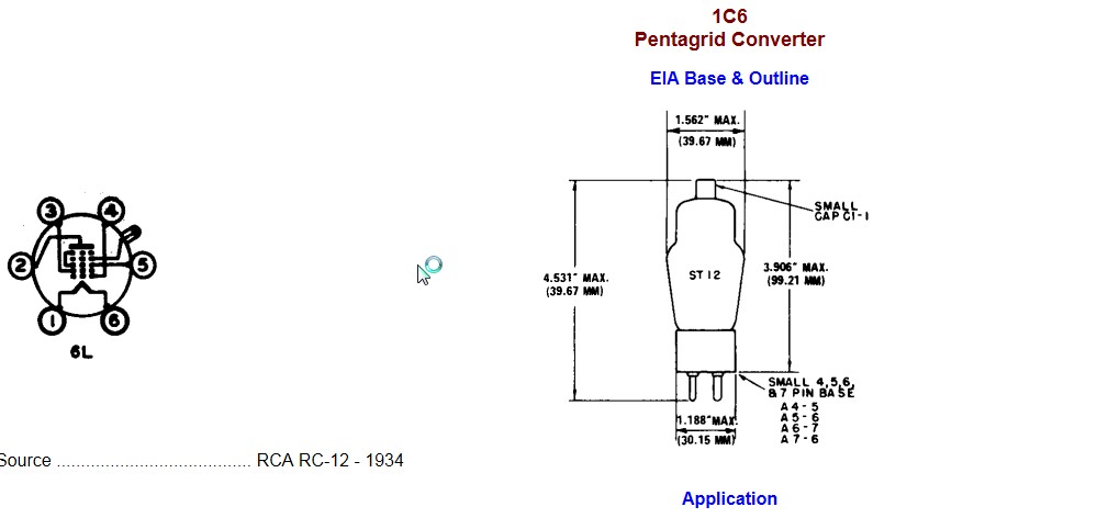

Yes, the convention applies to all tubes. The diagram shows the bottom view of the pins, and the pins are numbered clockwise with pin 1 at the lower left.
http://www.classiccmp.org/rtellason/tubedata/1C6.pdf
When you are working on the breadboard, you are looking down from the top and everything is reversed. Pin #1 is at the lower right and the remaining pins are numbered counterclockwise.

I now see you are using a 1C6 (somehow I had in my mind a 1LC6... go figure). Looking up this tube, I am seeing pins 1 and 6 as filament. From there it goes Pin 2 = Plate, Pin 3 = G2 (osc. plate), Pin 4 = G1 (osc. grid), Pin 5 = G3 & G5, Top cap = G4 (signal grid). This is from pin 1 (the first large pin) clockwise.
View is from the bottom of the tube (pin end).

Thank You Brenda Ann for coming into this confusing state of affairs.. No, the Tube has always been a 1C6, and looking at your pin out I do see a mistake I had made i had pins 3 and 4 switched in order, I origionally had pin 3 as the Osc grid and pin 4 as the osc plate.. And that may have been my origional problem all along..
So, Monday I will re-wire the tube and wire it correctly for pins 3 and 4, along with the rest of the pins and take some voltage readings and let everyone know what I find..
Hopefully this solves the origional problem, THANK YOU Brenda Ann..
This might explain why I had the grid, not sure which one glowed RED HOT when I shorted the dropping resistor when this origionally started, and which in turn made me think I had it wired backward, and so when I rewired it the dropping resistor showed nornal readings and the Osc worked, I don't know why.. I thought it was my mis-reading of what everyone was telling me.. And possibly all along I had pins 3 and 4 switched..
