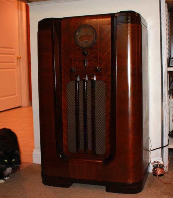

Herb, I'm hoping this comes through. This is what a restored 37-650 cabinet looks like. I am not sure of the photo attribution...Joe
Joe
Joe,
Wow! It is sure nice looking! I did find some similar
pictures online.
Mine needs alot of work then...

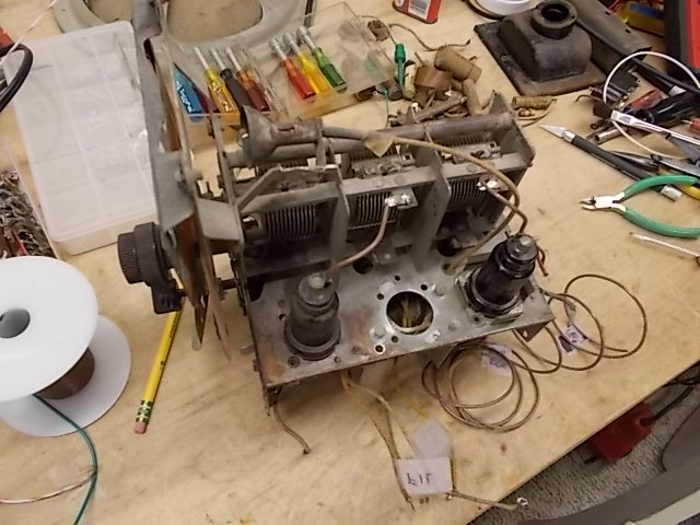

Just hooked up the RF chassis tonight
(separate on the bench with long wires) and
the radio works on all bands!

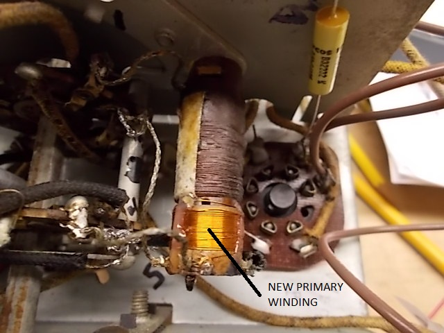

Update on the 37-650 Restoration:
I finally took out the Broadcast Band antenna coil and
it turns out that the messed up coil was the primary winding
which only had about 30 turns of wire on it. The secondary
was all good (had hundreds of turns).
I used some #32 magnet wire and got it all re-wound, and put back.
I now get MUCH better reception on the broadcast band!

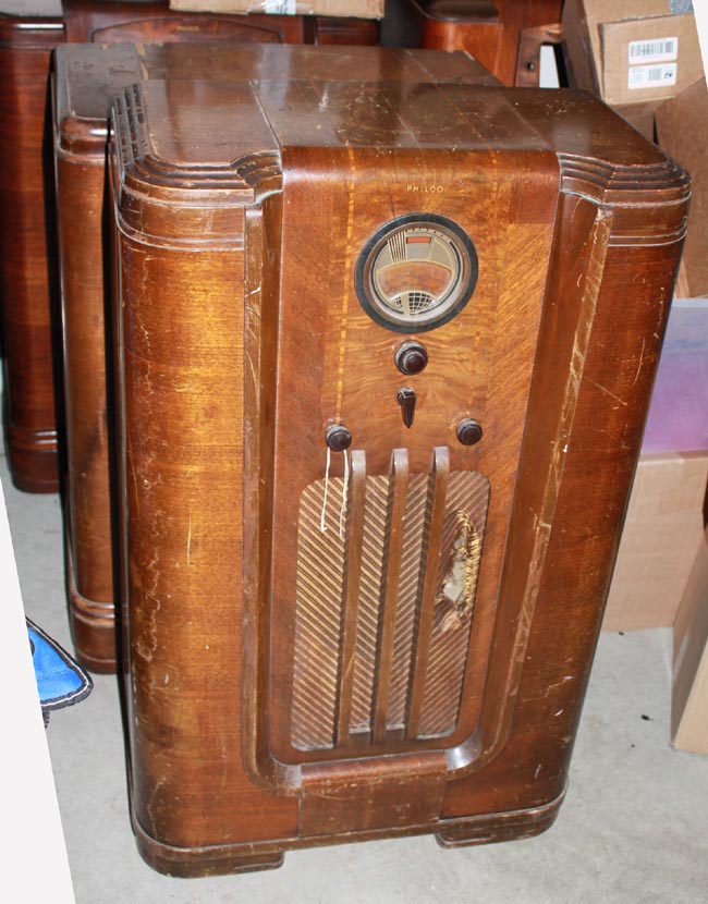

My $0.02 on the cabinet:
I'm like you. Decent on the 'tron wrangling, but not so much on the wood-working. Since the cabinet seems to be in poor shape, I'd take it on as a learning project without a second thought. You can't mess it up much worse than it is unless you set it on fire or drop it out the second story window. I'd be willing to bet you have a whole new feeling about it once you carefully get rid of that horrid paint job and see the bare wood.
It's not how bad you mess up, it's how well you can recover.

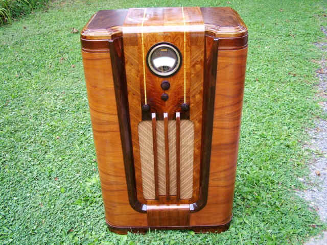

That cabinet might not be in as bad as shape as you think. You won't know for sure until you get it stripped. Mine looked a lot worse than it turned out to be and now I am proud to display it. One thing for sure, when you get it up and running, they are good sounding and playing radios. It will be well worth the effort.
Here are some photos of mine..
Before..
After.. It will be a big job, but you will end up with a beautiful radio.
