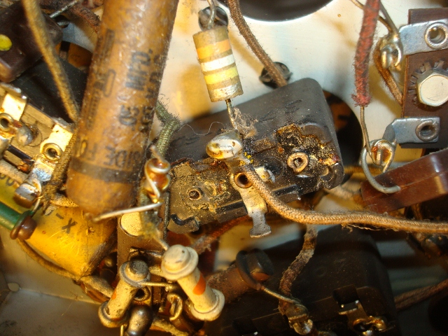

Here is the problem area. A shot of an undisturbed chassis would be of help. This is the #45 bakelite, which I think is a single .015 cap.

Nice picture Tim. You need to lift that block and read the number off the side. I suspect if it is a single cap in there it goes from end to end, one end probably ground. The center hole appears to have had no internal connection as you see no wire coming up. It could have been used as just a connection point for various other wires. The end connections clearly show wires coming up through them. That .05 was probably a replacement cap when the original inside the block went bad.
Refer to the number on the side and Chuck's nice reference to determine what was in there and where attached.

Thanks Jerry. It does look like a single. The center terminal hasnt been soldered to through the rivot. The number on the side is 3793-SU. It looks to be a single .015.

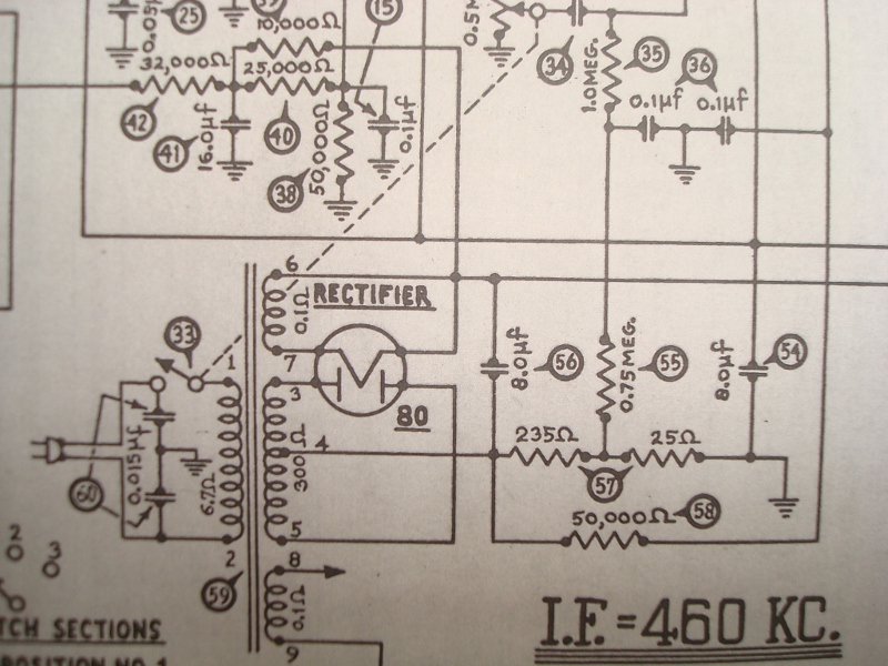

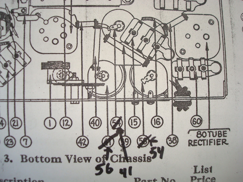

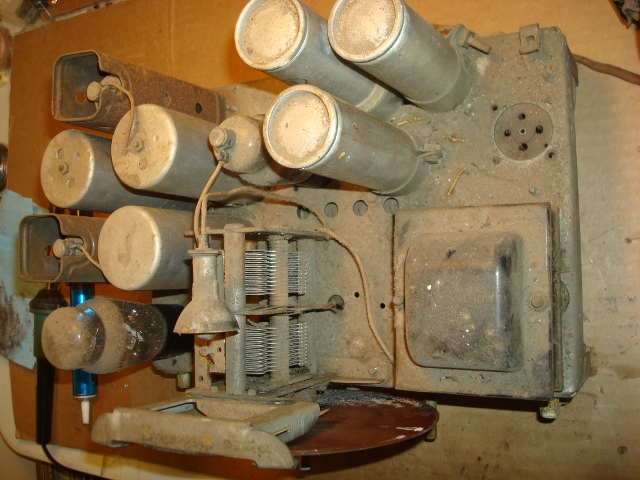

I have pulled the electrolytics and have a little confusion about things. The #41 cap is shown in the schematic as a 16mf to chassis gnd. The layout diagram shows it as the cap that grounds through a couple of resistors (to the HV center tap) - 8mf stamped (30-2049-M) on the can. This is the left cap looking at the rear. I think the #41 and #54 may be reversed, but I am not sure. The numbers on the can are: 30-2118s, which is the cap in the middle, labelled #54, and 30-2025, which is the rear cap closest to the side (RH from rear). I dont see any referance to these numbers in Chucks site. Clarification appreciated. Any problem replacing the 8mf caps with 10mf 450v?

Tim, nice to post a schematic with your thread. Looking at your first picture from the top of the radio it appears the center rear can does not go to chassis ground. Note the cardboard liner between the can and mounting clamp. You should be able to read cap values off the cans directly. Ten mfd caps should work dandy for the 8s.

Got ya on the micas. I found 100 and 120 pf caps. Would either of these be ok or should I parallel them with 10pf each? I was looking at the chassis wrong on the lytics, was looking at the diagram from below. Should have said it was closest to the power cord. Sorry for the mis-com. Anyway, I'll trace down things and go by the schematic. They could have put them in the wrong location on the diagram. I'm not sure how to post shots of schematics here - yet.

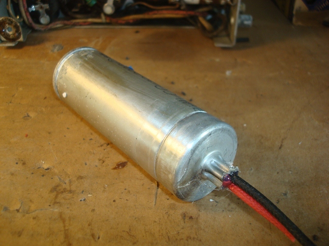

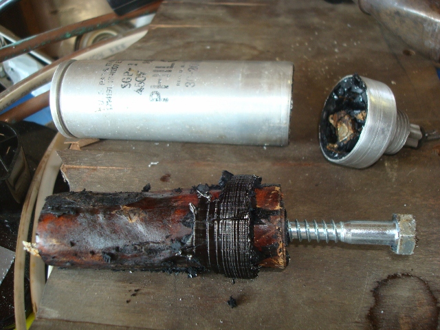

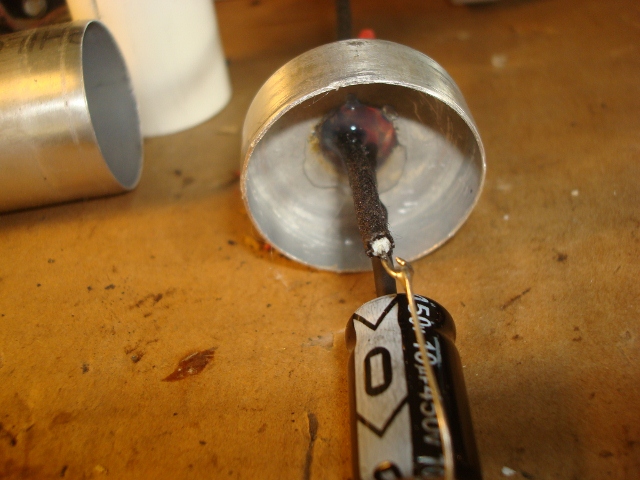

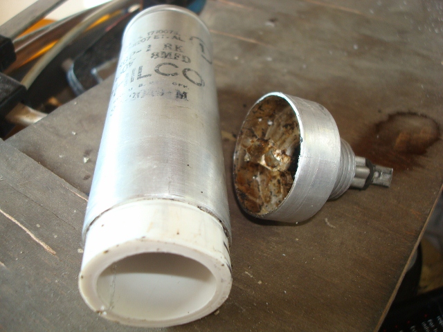

I started the electrolytic cap rebuild and found three different types, a tar filled dry cap, a dry wet cap, and a wet-wet cap. I am amazed that after 80 years this wet cap was still wet! I went through some threads and articles on these, and here are a few shots of what I did.
The tar pit:
I knew this one was different. This is the 1st cap off the rectifier tube (#56). I used a tubing cutter in this one, then since the stuff inside was rather fond of it's present location, I had to use a heat gun, lag screw and vice. Finally got it to seperate, then had lots of fun digging the rest of the tar out. Be careful not to dent or crush the can. Also on this one, seemed the lettering wanted to rub off.
I used the 1" pvc, cut a line through so it would squeeze and go into the can.
Here is the finished product ready to install. I used hot glue to secure the new capacitor in place, and ran the wires out the bottom. My next post will show in better detail this step.
Tim

I have traced down the diagram and found the under chassis location number of the caps in the diagram is wrong. The schematic is correct. Looking at the chassis from the top rear (dial to the front), the right rear cap is the input cap off the rectifier tube #56 8mf, and is the insulated ground, the cap to the left of that, nearest the 80, is the output cap, #54 8mf, the cap in the middle closest to the power transformer, with all the resistors under it is the #41, 16mf cap. I used a 10mf 450v cap for the 8's.

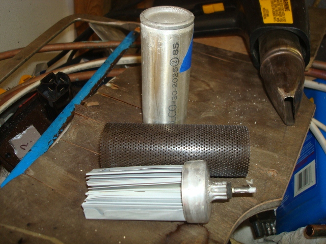

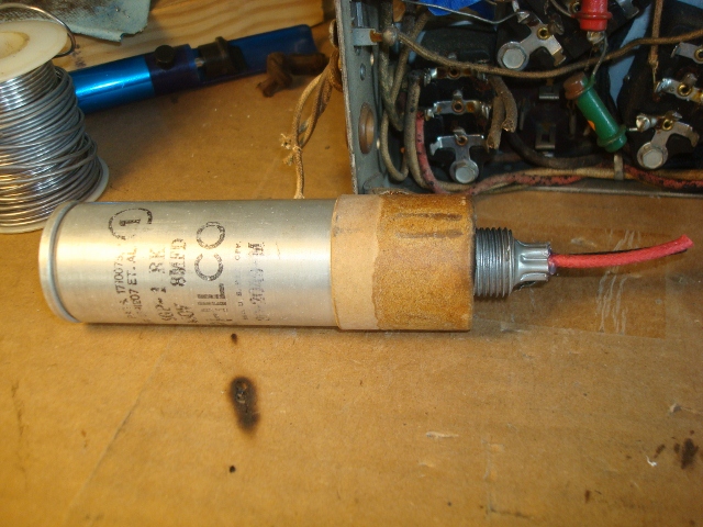

Here are some shots of the wet can rebuild:
I used a tubing cutter on this one, but it was a little tricky. It kept wanting to track off. The next one, didnt go good at all with the tubing cutter, so I quit and used a hack saw to finish. Not real proud of it, but it will be hidden in the clamp. I found it useful to mark the cans with a marker to help the line up when done. I didnt pot the caps, but did seal them through the hole where I ran the wires go through with hot glue. Holds things in place real nice. I used shrink wrap over the + wire of the cap. I didnt glue the can together and left enough wire inside to make re-replacement easier for the next time around. The clamp seems to hold things in place. Ill post a shot when I have them in place and tested.

Here a couple pics of the schematic and diagram. I marked the caps in question with (what I believe) are the correct positions. Hope this helps clarify.

I have some of the bakelite blocks rebuilt and two of the filter caps in. I used Morzh's technique on the bakelites. I had two of them that fought me tho. I think the wax must be a little softer on some over others, and my allen wrench tended to push through instead of pushing the stuff out. I could still dig out with a small screwdriver, just wasnt as neat as I'd like. They were identical caps, so I hope the rest will push out like the line filter. I found the reason for the clipped lead on the #45 block - looks like R30 has been pretty warm at some point, probably from a leaky cap in the block, so they "fixed" it by clipping the lead. Another note is the wires from the plate of the 42. The tone control wire was bad bad bad. Also the wires from the speaker were bad, so they got replaced. I replaced the wire all the way to the 42 plate since it would crack the insulation if flexed - with full B+ on this one, I wanted a good wire.
