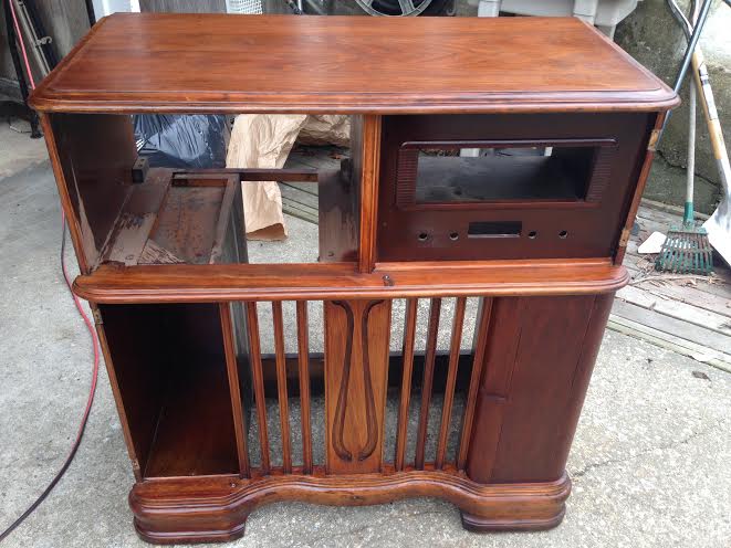

I got this LC 759 yesterday and was going to use it as a veneer donor but I was looking at it this morning and the cabinet is really nice. The veneer is so nice I started stripping the drawer and top. the phonograph is missing and the bottom legs will need veneer work but the rest is solid and without damage. I have no room for it so I would end up selling it but these dont seem to have any value and it will be a lot of work and use a lot of supplies and time.
Please give me your opinions.
Worth restoring?
Parts cabinet?
Restore?
Hmm, it would all depend on how good a performer this unit would be. What make is it? Also, is it pre-war or post? It does have a nice look to it the way that grill is designed and I'm sure a donor phonograph could be found or even made to work with this unit.

Perfect veneer donor. You'll be glad you did it, just as soon as you need some veneer. There are better radios out there that require your time.
Well,
With my pity for this piece I have decided to restore it even without the phonograph. I have been working since last night and here is the outcome so far.
It's looking a lot better.
Wow.. that's amazing. The cabinet is beautiful. Good choice to restore it.Icon_smile
It looks really nice so far. As far as working for free... I have restored a few radios that I had really no intention of keeping, and I knew they would not sell for much more than I paid, but I did it just for the challenge, and as a pass-time.
But also, in some way, as a service to the radio it self, and to the hobby. I know that someone will look at and maybe listen (if there are any stations left) to the radio long after I have passed away.
You are preserving a little piece of history my friend. And doing a great job.
Exactly!, I cant let the history go... This was made to last and has. It has been messed with but is solid and still beautiful
My question is this:
Do I tone this piece?
The bottom was darker and the grill bars. Someone covered the whole thing with colored lacquer long ago but underneath it looked darker in spots.
Do I just lacquer it as is with a gloss coat?
