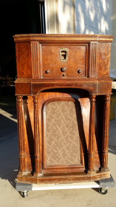

From an estate with about 10 other radios:
The top has been refinished already, so I will probably restore the whole cabinet. Anybody need a piece of carpet?

The set originally had all globe tubes. The 37s are out there. The 42 globes will be the most expensive.
I am in the middle of restoring a model 15X chassis/cabinet. It is definitely NOT the easiest cabinet that I have ever done......
