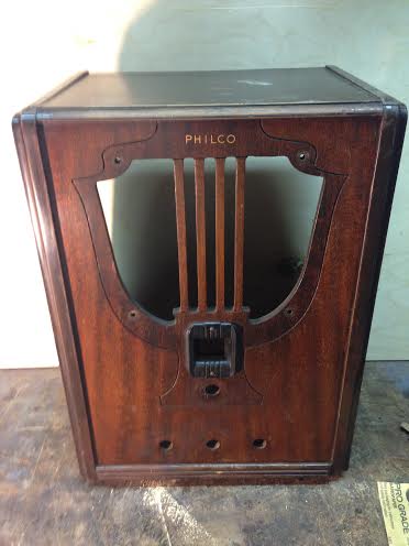

Here is the last one. The philco 66 cabinet is not awesome condition but the front is nice minus the wear on the areas around the knobs and some clear flaking. The rest of the cabinet need a redo but what do you guys think?
Full resto?
This is why I di not give it to you the first time - the face looks good and I thought maybe it was fine the way it was, but then I looked at the top....maybe we should keep the face.

Well I got really bored and sat in my chair and worked a little.
Stripped the face of the cabinet and then did a final thinning.
