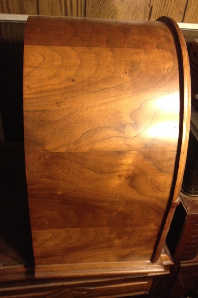

Both my 70's were/are original bookmatched veneered across the back, actually I have never seen an original 70 that wasn't bookmatched, both of mine are and all 3 90's I have owned in the past were also.
Not saying all 70/90's were, just the ones I have owned or seen have this type of veneer. I don't know what later or maybe earlier sets used but I know the one I'm working on had it to start with and I want to replace it as close to original as I can.
(This post was last modified: 08-16-2014, 09:33 PM by tab10672.)
Posts: 411
Threads: 42
City: Ironton Ohio
Original veneer, only refinished.
Posts: 1,562
Joined: Nov 2008
City: Sedona, AZ/Placentia/CA
Tab, right and I'm wrong as usual! I was thinking of the few other Philco cathedral radios I have had and all were a single piece of veneer. Very nice touch.
