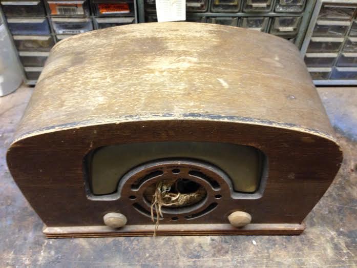

Here is a little Zenith 6D 2620 I am currently working on

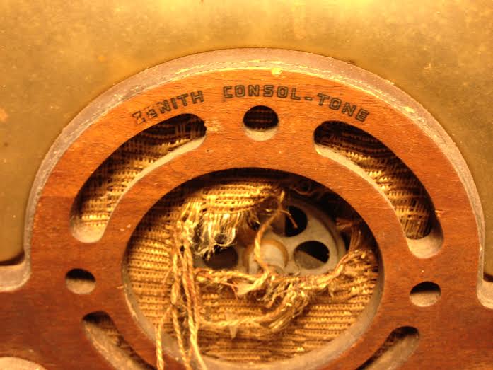

Problem is that no one has the decal for it. It also needs a new dial cover. I may create a mold but I may give in and just buy one at K-town. Icon_rolleyes
Gloves on, strip, gloves off. Wow that was quick!
1 veneer flaw and gone
Sealed the cabinet last night and grain filled today. May need more coats. these grains are deep.

If the dial cover is not cracked or warped you may try using automotive rubbing compound use a very small buffing wheel/pad or by hand works very well. the cover will retain its patina look and you will be able to see the dial well .save your money
What is your grain filler of choice? Also, what color are you using...it looks like it will give a nice darker contrast in the grain.
Charlie in San Antonio
I will try that for the dial cover but it is kinda ratty for me.
I use Mohawk Grain filler and am happy with it once I dilute it.

Then stained the cabinet. No toner on this one. She is the same color already. Will let he dry and then clear a few coats. Someone I know is making me a decal for the front so hopefully that will work.
