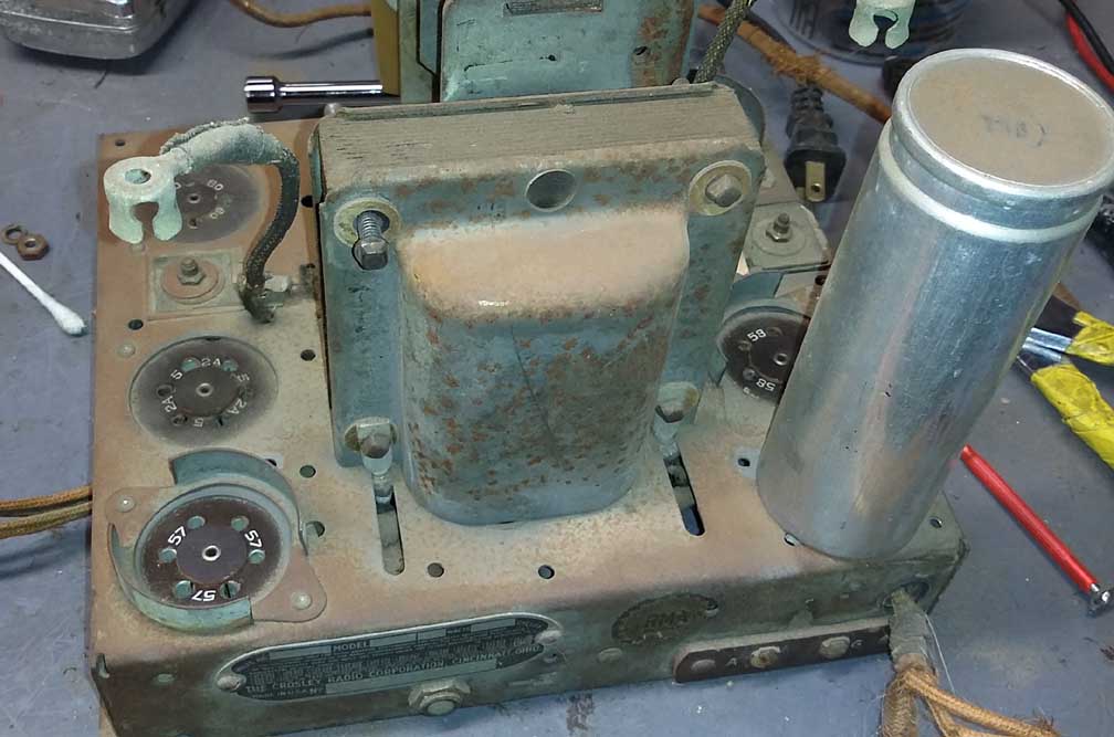

I finally found a radio to work on. I rescued it from some garage sale. You can see it's a had a tough life. It's been wet and missing most of the fluted molding on the base. And is will need new grill cloth. Oh and I paid a whole five dollars for it.
You can see the chassis is typical condition with some rust.

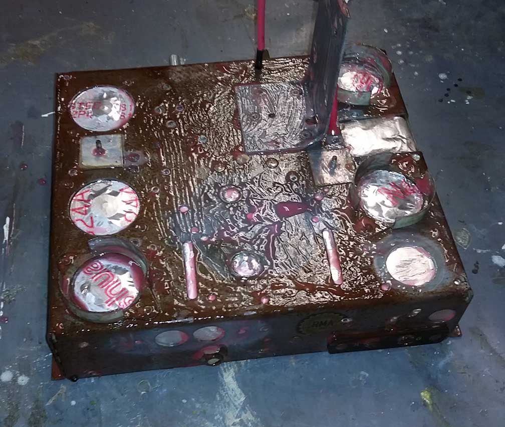

He it is stripped down ready for navel jelly. No surprises so far. I did cover all the holes with foil tape and small ones with hot glue so the all that goop would not get underneath.
And here she is all slathered up. This stuff works wonders on rust. It just takes a little time.
