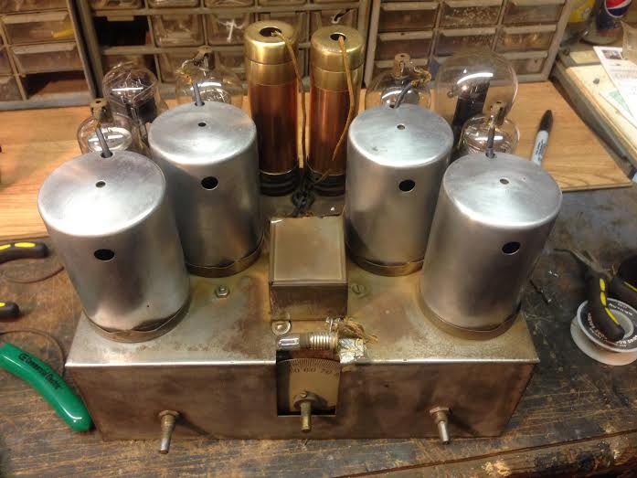

I have put aside the 37-620 and am working on my Bell swan.
I am having trouble with the Ecaps. I was told that I have version 2 on the schematic but don't know where to ground these Ecaps.
The first 2 are in the metal box on top of the chassis. I believe they are 1 Uf each.
There are 2 wires coming out going under the chassis Is this where the positives connect to?
When I removed the tar block there was a wire connected to the metal box. Is that where I ground these?
Next are the 2 cans that each have one wire coming out but no other wires. Are the 2 wires the positives?
If so, how do I ground these?

The cans screw in to the chassis so I am guessing that the ground is attached to the can. How would I attach the ground to the can?
You can see the block open and the wire sticking out that is attached to the can. Is that the negative for both 1uf ecaps?

I think that based on the picture on page 2, tihere are (2) 1uf caps in the block that the negs are twisted together and grounded to the block/chassis and the positives connect to 1 outgoing wire each.
Then there are (2) 8uf caps grounded to the cans/chassis with the positives connecting to the wires coming out of the top.

Ok a few questions.
1. In pic one there is a 1 uf cap with a ground side. Is that a Ecap?
If so can I just ise a 1 uf regular cap?
2. I am trying to solder the negative to the copper can but cant seem to get it to stick.
Any ideas?
3. In the block should be double 1uf Ecaps. Can these be replaced with regular caps?
Thanks
Kirk
1. Yes, you can use a regular cap rated at 400 volts or higher.
2. Surface has to be clean and an area that large might need more heat than what you're using puts out. Clean the area well and use some flux on it. An alternative is to run a ground wire out the bottom and ground it at a point under the chassis as close as possible to the cap.
3. Yes, you can use regular caps if the voltage rating is high enough.
