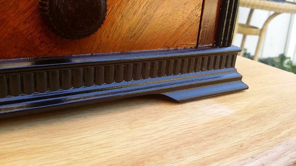

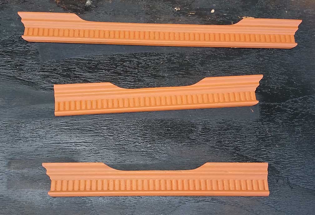

Next I got to work on the cabnet. If you noticed most of the molding on the base of the cabnet was missing.
The original molding was fluted and very difficult to make. And since this is no specal radio I decided to make my own from some molding I picked up from Home Depot. After cutting it down on the table saw it looks like this. With a little paint to help match the color of the other wood before toning.
After much trial and error this is how it turned out. This is the first time I have used  Mohawk tone spray. I found in some ways it's much easier to use than stain and other way it's harder. I used the extra dark walnut for the base.

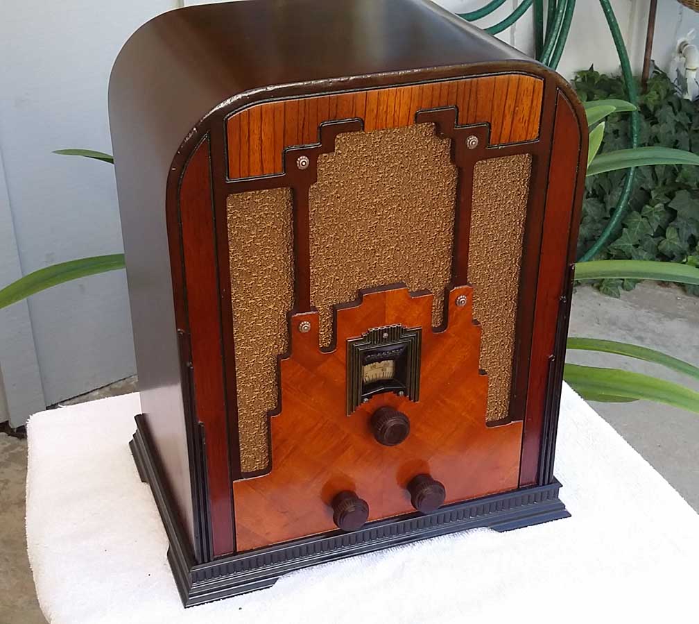

As for the rest of the cabinet. I looked online and found pictures where it was finished all different ways. I couldn't find any pictures of what I thought was an original finish. So here's how I like it.
I used mostly perfect brown on the rest of the cabinet, which I found to have a reddish tint to it. And the extra dark walnut for the accents. A little bit that goes a long way.
I used semi gloss lacquer for the finish. Sorry it's not gloss. This thing is pretty rough looking with gloss on it.
The escutcheon for the dial was silver and I didn't think that was appropriate so I gave it shot of perfect brown.
And the the grille cloth was too brassy before I gave it light dusting of perfect brown. This was the closest I could find to the original pattern and color.

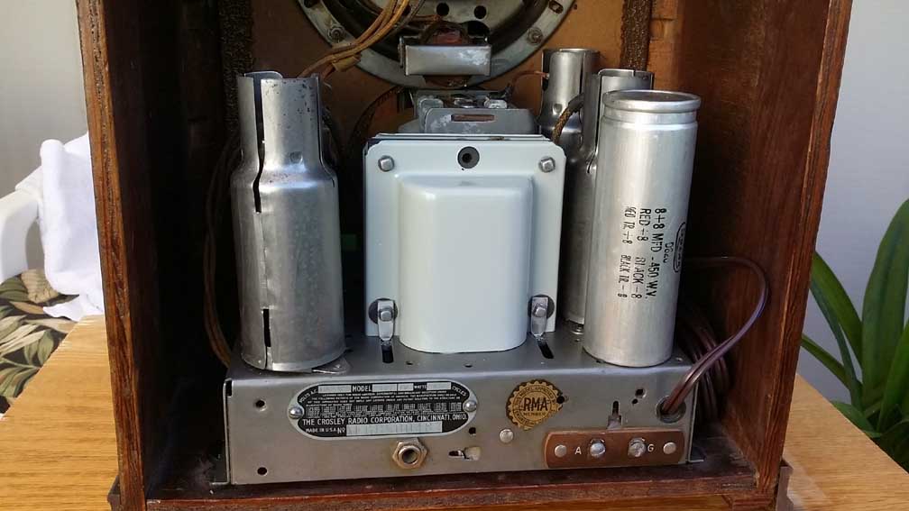

And lastly the rear view.  You can't see them but I used faucet washer for the spacers under the chassis. They worked real nice.

WOW....WOW Great job !! By looking at the first pictures and then the final pictures the way the radio turned out,you would not think that it is the same radio. Hats off to you!
If it looked sort of rough after lacquering that may be because it the cabinet needed to be grain filled, it's just about impossible to get a nice gloss finish over walnut, mahogany, or any other open grained veneer without it.
