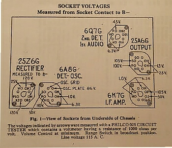

Here's a dumb question.  How do I meaure the plate and screen voltages on tubes 6A8G and 6K7G?  Also, I carelessly broke one of the lugs on the brodcast antenna transformer.  I think I am able to rewind it if this is something that's repirable or, better yet, can I get a replacement part number 32-2141?
Thanks in advance for your help.
Dave

Hi Dave
B- on your set would be at the off/on switch.
Connect the - lead to it and the + to the pin
that is to be measured. With modern meters
the measured voltage will read a bit higher
than what is listed. They don't load the
circuit down as much as the older ones.
