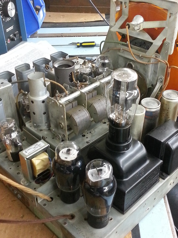

       Im going to post pictures this week of a fully restored 38=116 xx that's been in shop for a while and near completion. I have a lot of time on my hands due to job loss and restoring radios to keep busy . These radios that I have been showing off are my personal radios. Now I am thinking of selling some of them? And {if) I do so I would like you guys to have first grabs at them, im not posting these pictures here to sell them , I know to go to the for sale section on this site. Just wanting to share these pictures with people who have the same intrests as I do. I have other posts under non Philco also.
                                  Here are some pics , not finished yet but will be soon , getting an alinement done

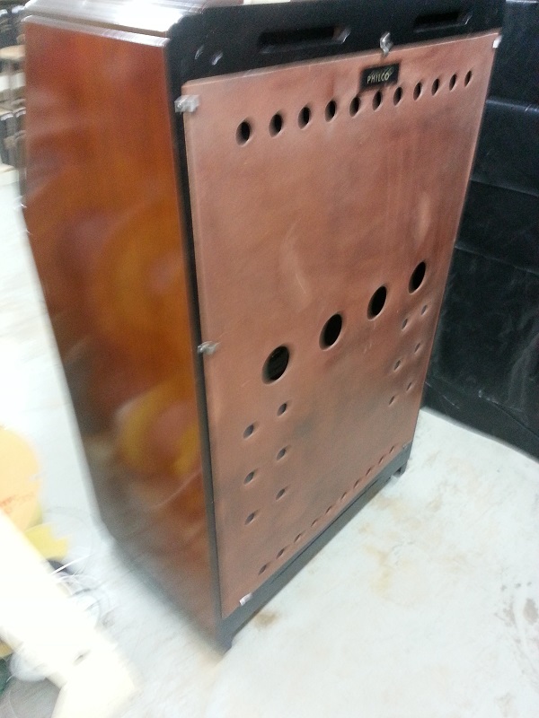

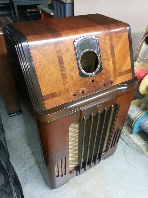

 I posted some pictures now, still not done

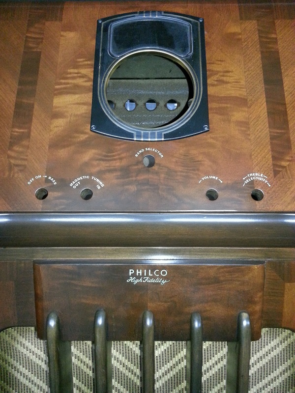

 Thanks John , do you know about the pilot lamps  (flood lamps )that are on that set, it seems they should go on when magnetic in /out switch is turned <> , im not talking about the dial lamp, those pilot lamps are way down there and dont seem like they would do any good to lite up dial any, what are they there for
That's a "wow!"
That's beyond snazzy, great job!

Yes, the side dial lamps come on when the magnetic tuning switch is turned "on". It lights up the station tabs, although not real well Icon_mad

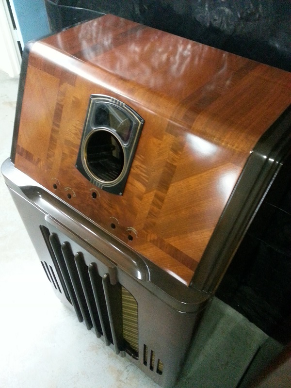

I'd like to know how, after you sprayed your final lacquer coats, you got the front and top on this so silky smooth looking:
[Image: http://philcoradio.com/phorum/attachment.php?aid=6278]
Did you do the final rub out by hand or with a polisher? Or did you even do a final rub out?
Also, what gloss lacquer did you use... satin, semi-gloss, or gloss? Or were the first few coats gloss followed by a couple of semi-gloss?

 I did not rub it out , if you can spray without getting any trash in the clear you did good. The gloss level  is  semi gloss  . The smoothness comes from , 1. how you mixed your clear and that depends the temp when clearing, the more thinner added will make waterier ,you have better flow out, all the thinner is for is to make the clear thin enough to be sprayable, you have to use slow dry thinner in summer and fast dry in winter, you don't want the clear to dry to fast , you need a good spray gun with a # 4 tip.  I have 3 coats sanding sealer under the 4-5 coats of semi clear. I only buff when I use high gloss piano finish , high gloss has a gloss level of 90% you have to buff to get that 100% gloss level, wet sanding and buffing gets rid of any orange peel. There is a lot to it , I been painting high end cars for long time,  I still don't everything, Lots of practice I quess Icon_think
