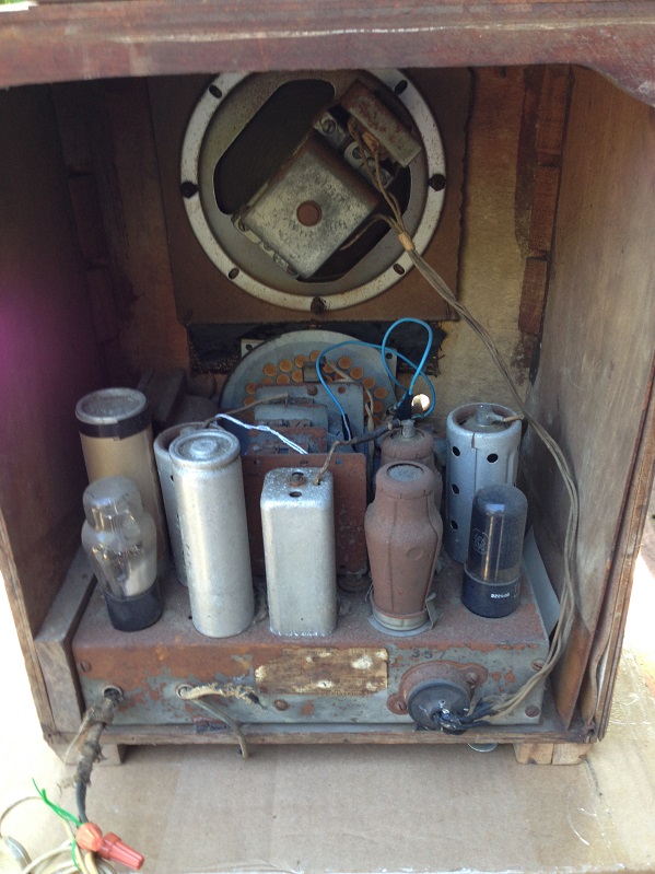

OK, got to the other coil.
Good news: the largest coil is open, was able to count turns.
The other two are good. I am inclined to reuse the bobbin and the two existing coils if it proves sturdy enough, as one of them is some thick litz wire, and I don't have any.
Will see....
#74
This is the second coil.
Before
After
#75
...and installed.
The wires coming from inside the chassis plus the ground wire attached to the bracket give it enough rigidity.....well, as it was before anyway. Otherwise I'd have to make a new bobbin, and then the whole coil would have to be re-wound.
Once the conformal compound comes, I will install the first coil, fix the wire on the IF coil underneath and ..... fire it up!
