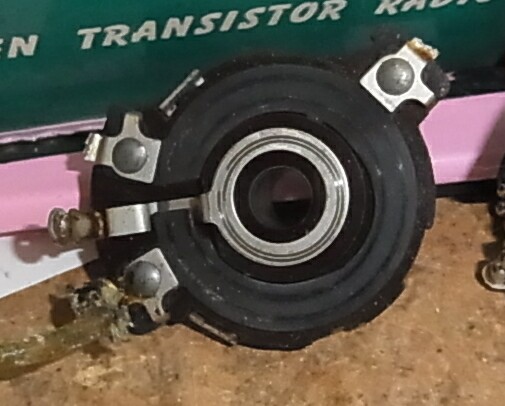

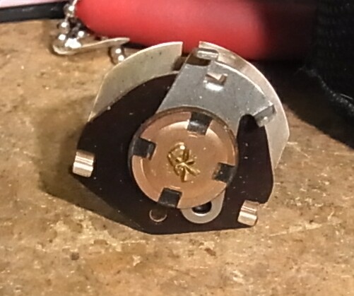

The innards of the volume control. Note the rudimentary clutch. Just a simple slip clutch to keep the motor drive from binding..

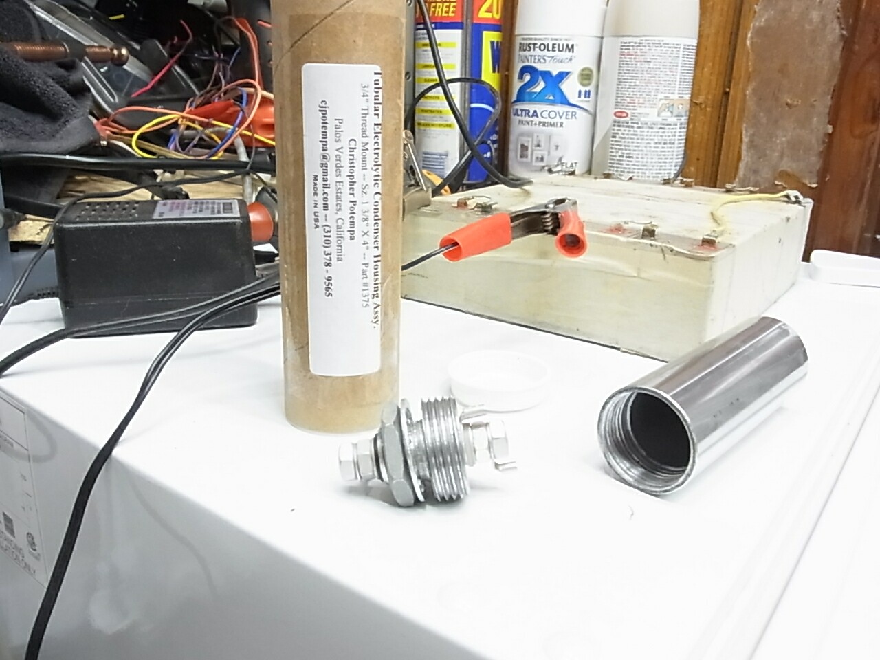

Ever seen these before? I bought three for "special projects", which ended up being this radio. Excellent workmanship and sure save the worst parts of restuffing the original 'lytics. With the added benefit of being able to easily replace the component again later. Most interesting of all? You could even use them to restuff those oddball bias 'lytics with the can positive!
#33
(04-18-2015, 11:46 PM)BrendaAnnD Wrote:  Ever seen these before? I bought three for "special projects", which ended up being this radio......
No, I've never seen or heard of them before.  Doing a quick search I couldn't find a website or any info on them, other than I think fellow who made them is a Certified Machinist.  Do you know if he still sells these and were they very expensive?
I think most of the time I'd prefer stuffing the originals, but there could be special occasions where they might come in handy.
#34
I don't remember how much I paid for them. But his email is on the label (cjpotempa@gmail.com), so I would contact him to see if he still makes them.
