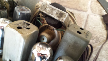

I read somewhere on this forum how to rewind this type of oscillator but I can't find it now.  If someone could point me in the right direction, I'd appreciate it.  A picture of it is attached.

Just thinking out loud here but couldn't I just replace the field coil that's screwed onto the speaker? It looks like that's what the last owner did or could that have been the problem in the first place?
Pictures of the speaker.
That is not a field coil screwed on to the speaker. That is the output transformer.
The field coil would be attached to the back. It would act as the magnet you see on the back of modern speakers. It is always i. Line with the center of the speaker.
So either that is some crazy speaker design I have never seen before, or the field coil is straight up missing. I've never seen an EM speaker with the FC removed though.
