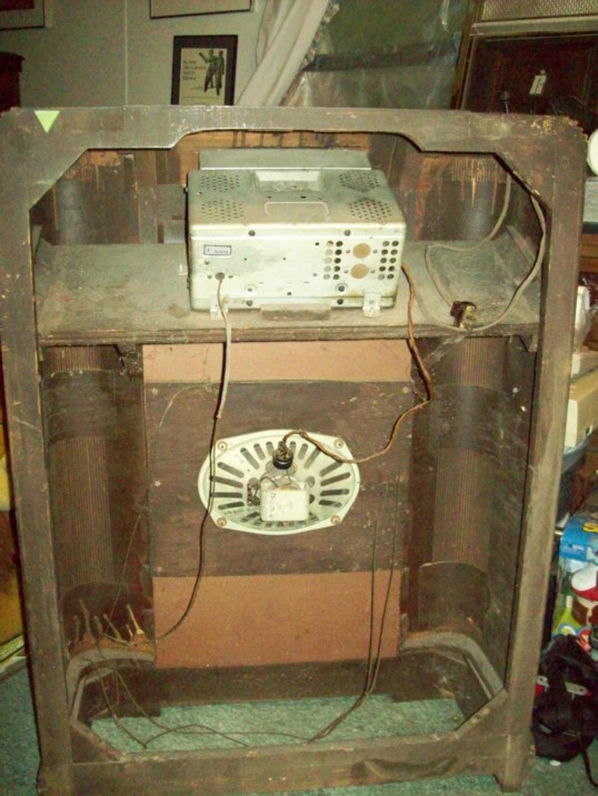

After a couple weeks of no responses to my emails and phone calls, I decided to stop in personally at the shop in Barberton to see if the Philco A-361 console was still there. Turns out the shop had changed hands and the Philco was still there and priced $50 lower than it had been in the ad! So, I snagged a nice Philco A-361 console that seems to check out on transformer and even picks up a few stations when brought up on reduced power. Shows plenty of good signs. Cabinet does have a few blemishes, including a crack above the dial that seems caused by poor wood. Speaker looks good except one spot I repaired at the edge of the cone. Actually looked like the paper was simply too thin and wore away over the years. I think with a recap, and a good realignment, this will be a nice set from a unique time in radio history. Chuck: Do you have any paper work on this model I can order?
P.S. The one picture came out dark and grainy, I don't know why. Radio looks better than that!

More good news with this radio. Tested the tubes and all were very good except the 7B8 tube which read a bit weak. Luckily, I had a better 'Genuine Philco' 7B8 in my stash to swap into the radio. I must say, these loktals are fairly durable tubes overall. Both dial bulbs are blown, but everything else checks out so far. One question I have is cleaning the slug tuners on these units. As I said earlier, it will tune some stations on low power, but it's VERY touchy and I am suspecting dirt and crap in the tuner. Is there a safe way to clean these or should I simply use compressed air to get the worst of the gunk out of the tuning coils and slugs?
