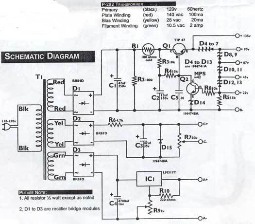

Here is a scan of the schematic:

Secondary 3, LED in series with 2K to 10K resistor depending on the LED efficiency and desired brightness.
The LED works perfectly hooked up as you described. I also have a small fan that I'd like to place on the box directly in front of the A voltage regulator's heat sink. The fan is 12 volts and 0.06 amps. Will a 1 watt 300 ohm resistor work across the second secondary (28v at 20ma) to bring the voltage and amperage down enough for the fan?

not sure how you want it: your secondary is 20mA and yu want to load it more while your fan needs 60mA?
I would try the same output as for LED, it has enough oompf A-wise and a 12V fan might work just fine from 10.5V unless it has undervolt cutout which is rare.
I tried placing the fan across the third primary, and it works, but seems to turn a bit slow. I also think my fan might be too small for my purpose, so I might drop by the computer parts store tomorrow.

yes it will be a bit slow, it is down 13%.
Here's an idea: measure D3 output, see if it is close to 12V.
I measured the D3 output, and it is close to perfect. 12.47 vdc. Will the .47 vdc hurt my fan?

For the record, I placed the LED across the third primary in series with a 10K resistor, and the fan just above C4 at the D3 output (which showed 12.47vdc on my mutilmeter). Please advise me if any of you see an issue with either placement.
Charlie in San Antonio
No issues. However if you want peace of mind, 8 Ohms resistor in series with fan will drop about what you have above 12V. And it can be a small 1/8 or 1/4W resistor.
 I don't think that the fan will be necessary with the LM317T, they don't run hot enough to cause trouble so long as the heat sink is of sufficient size. There are big stereo amps that handle more current then any of the semiconductors in this power supply, and all they use are large convection cooled heat sinks. I would keep the extra secondary free in case you want to add a "C" supply to the unit.
