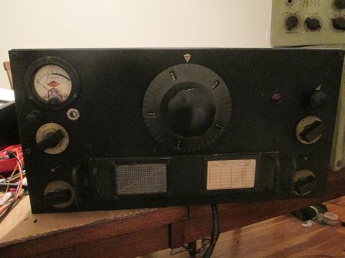

So the L76 has been calling me by name since I moved it to the dining room table about 2 weeks ago. So I put on my bib overalls (this means I mean business). Grabbed my free SG-7 (Heathkit signal generator) that a friend gave me. and started at fixing L76. Well found why I got it for free, it makes rf but no modulation (400cy tone) which makes it a pain to use. After a half hour of looking up the info on it, replaced the filters and found a leaky paper cap that was the issue with the modulation. Now it's up and running properly!
Hooked up the power supply and powered up L76. As I posted before when I power it up seemed like the audio stages where working but the rest was unknown. Connected the generator to the second IF stage to see if it would pass a signal at the IF frequency (456KC). No dice! Then I checked the resistance of the IF transformer. Bummer secondary is open. Popped the cover off the transformer to investigate further. Both winding checked OK. Hmmm. Turns out I miscounted the pins on the detector tube socket where the secondary is connected. Cleaned it up a bit and back together it went.
But why won't pass a signal at 456KC?? Well I let that problem go for the time being and went to the 1st IF stage. Hooked the generator to the input (control grid) and then hook a signal tracer (it's an audio amp with a diode connected to the input so it can turn a RF signal to an audio signal) to grid of the second IF stage. I was rewarded with a weak signal from the tracer. So what do you do when you have a weak signal? You make it stronger, in this case by repeaking the transformer.
After that I went to the plate circuit of the mixer tube. This set has a crystal filter which is used to give this receiver very good selectivity it's connected to the plate of the mixer. Sets without a filter the mixer would feed the 1st IF transformer.  I wanted to see of it would pass a 456 KC signal. It did!
So what about the last IF not working but the transformer is OK? Well What I found was the adjusting condensers had oxidized so they where way out of tune (resonance). These IF transformers use small air variables not compression trimmers. The oxidization had formed at the rotor bushing. Out came the De-Oxit and a quick squirt into all the IF adjustments. Repeaked the IF stages and the last one peaked right up like it should (before it wouldn't peak at all). Funny thing they use the same tool to adjust as the Philcos a 1/4 hex nut.
Now it's picking up the generator thru the whole IF strip, detecting and making audio. The audio is distorted I'm thinking there's a bad mica cap in the detector stage.
More later! Stay tuned.

After the IF strip was working what the heck let's go for broke connected the signal generator to the ant post and see if the RF and mixer are working. Sure enough they where kinda. Had the chassis up on end to measure and connect the tracer and such. Lay it down flat and it would quit. Grrrrr. Turned out to be a loose tube the 1st RF amp tube.
So now it's picking stations but has some major issues. Audio is wicked distorted and low. Someone replaced the RF gain control but wired it backwards full is ccw and all the way down is cw. The volume doesn't work properly raises the tone a bit along with the volume.
At first I thought the distortion maybe an AVC problem so I measured the control grid voltage on all the RF/IF tubes. Looked ok. then I used the tracer and listen to the signal at each stage. Ahah!! All sounded nice and clean till I got to  the last IF amp. Grid was good. Plate was awful! Very distorted. Measured the cathode voltage and it was way high. Methinks the 300 ohm cathode has gone open. Soldered a replacement across the old one and now the plate signal is nice and clean too.
Onward to the volume issues. Still low and the distortion is better but not gone. Started thinking that the volume control was open. Flipped it back over and took the nut off of the control and there it was. The lead connecting the detector to the control was broken at the solder joint. The pot came off the chassis and took it apart to clean it.
Cleaned it up made a small splice for the broken connect and got it all back together.
Power it up and was rewarded with a mostly working set. Lots of volume distortion is gone. So now there are a few minor issues. Backwards RF gain control, crystal filter doesn't work( probably need the crystal cleaned) need the IF alignment again ( with the last IF amp working properly it needs to be dead on the crystal frequency) New cloth covered power cord and some cabinet stuff.
A very happy

The backwards RF gain control is bugging  me so out it came and install a nice new 10K linear taper Allen Bradly pot in its place. Now it works in the proper direction but all the gain is at the last 1/4 " of travel. The one that was in there did the same thing. GRRRRR. It's wired as a rheostat(just the wiper and one end are used) so I could just replace it with a smaller value and that would correct the problem. But that is tooo easy. I want to find out why it doesn't work with the stated value. I like headaches!! Maybe the original (that I don't have)has an odd taper that has very little resistance is at the far end. I will have to ask 7C and see what he sez!!!

A few new developments with the HRO . I finished up the loose ends, installed the power cord, replaced a few ecaps under the chassis, and removed extra parts I was using to troubleshoot. Buttoned up the bottom and installed the cabinet and going to called it done for now. It still has some minor issues like lettering on the knobs needs to be refilled just little stuff.
