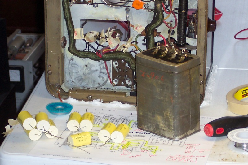

Hey guys,  my parts have arrived.
The final part of the electrical restoration has arrived.  Since the new dry caps are quite large and will be taking up a lot of room, I have decided to re-stuff the filter condenser can.  Just now, I was able to rid the can of it's old filter caps.  Plenty of tar in this one!  My method, if any of you were wondering:  I first gently pulled off the can lid were all the solder connections were.  Next I cut each wire to separate the can from its lid.  With the lid off I was able to take a cork screw, attach it to the filter block and pull it out as one piece after heating up the can to soften the tar within.  This process did take about 15 to 20 minutes.  It works well for me though.
In the 3rd picture you will see my replacement caps.  All these caps are rated to at least 600V.  Values are close but not exact.  You will see the actual MFD values that will be used, on picture 3.
The schematic calls for values MFD as:  0.4mfd    4.0mfd    2mfd       1mfd          2mfd        .015mfd
                                        My values:  0.5mfd    5.0mfd    2.5mfd    1.25mfd      2.5mfd     .015mfd
Will this work?
Also I take lug number 5 as being a true ground?  I am having a troubled time trying to figure out how to wire up each cap to it's lug.  For example:  Would lug 6 and 8 be connected together (one side of .015 on lug 8 and the other side of the cap on lug 6?)

The values are not really critical if you are + a .5 to 1mf should be a problem. If you where using 10 or 20mfd that's a problem

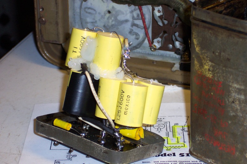

Hey guys,
I finally finished the main filter block.  I followed the wiring diagram to a "T".  Here is a picture of the end result.  Everything was tested and double checked, a successful repair!  If you look on the can within this picture you will see that I essentially wrote with a grease pen that the can was "Re-Stuffed"  for any "future radio restorers".  I was able to just snap the lid with all the parts attached, to the rest of the can.  Friction held it on originally, and I was able to replicate a very similar process without damaging the can itself.
Next I hooked up a fully restored Heathkit T-2 Signal tracer (with universal output trans to use as a test speaker) to the speaker jacks correctly via the Heathkit owners manual (no output trans on this receiver it's self).  The original speaker is missing from this set and I do not have another magnetic speaker on hand.  I turned on the set first with a dim bulb.  Power trans has no shorts, bulb lit and dimmed very nicely.  Next I powered the set up at 110VAC via a variac.  All the tubes lit including the pilot lamp, but no sound despite the variable condenser and knobs manipulated every which way.  I have a 70 ft outside antenna connected properly.  No ground connected though.
I next tested what voltages I could on each of the tubes, they seem normal, results below.  I tested all three chokes, results not recorded, but all tested around 200 OHM, I would say they are good.  I also tested 1st and 2nd AF trans, results below.  No opens, but the secondary on the 1st AF (one side to ground, other to the grid of the 26 tube) read 1.41 MEG OHM while all other primary/secondary readings on the AF transformers read in the thousands.
I am thinking the secondary on the 1st AF trans is open due to this 1.41 MEG OHM reading, thus causing no sound out of the receiver.  I am only a novice at this stuff and it took me this last week with the help of books/reading and several friends to figure this out.  What do you guys think????
