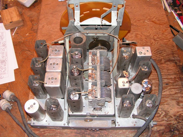

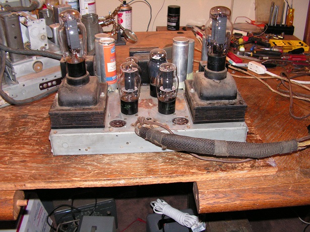

I just pulled the 2 chassis' out of my 37-690 to get a good look at them, and I find that I have what appears to be a 38-690 chassis in my 37. There are 6 tubes on the power chassis instead of 7, and 14 tubes on the receiver chassis instead of 13.
The tube layout on both chassis' match the 38-690.

 What power output tubes are used in the power supply/amp chassis? The 37-690s used 6G4Gs I believe, whilst the 38-690s used 6L6Gs. I would not rely on that alone, however, if someone was unable to find the 6G4S they may have decided to update the chassis to use 6L6Gs since they are much more common and used in the 38 model anyhow.

Thanks Arran!  The output tubes are 6L6. I compared the differences between the 37 and 38 chassis and this has all the tubes that should be on the 38. In addition, there are definite differences between the chassis layouts.

Does the tube diagram inside your cabinet have the 37-690 or 38-690 tube layout? This would be a key bit of evidence.
The tube layout in the cabinet shows the 37. That's what confused me so much!

While it is entirely possible that Philco did some cross-matching at the factory, the fact that the cabinet still has 37-690 stickers indicates to me that someone installed the 1938 chassis at some point after it left the factory.
Yes, Philco did make their own Phranken-Philco sets, more often than some folks may realize. Case in point: I own a 200X. Only it isn't a 200X. It has a 201 chassis inside. And the cabinet stickers indicate model 201. One of the stickers was placed over a 200X sticker, but in such a way that you can still read "MODEL 200X" under the 201 sticker.
That was a factory job. And it must have been done towards the end of production of the 201, and here's why:
My friend, Steve Geary came over here about a year ago. He had a 201 chassis with him. His set came with the stock 201 cabinet. The serial number on his is lower than the serial number on my 201 chassis, so mine was made later. Since it was mated up with a 200X cabinet, my guess is that Philco was closing out their 1935 model line in preparation to introduce the 1936 models, and started clearing the factory of all the leftovers. My Phranken-200/201 is the result.
On the other hand...
A few years ago when I was still restoring radios as a sideline, someone sent me a 37-690 upper chassis. My job was to mate it with a lower chassis.
I couldn't find one.
So the owner found - and bought - a 38-690 upper and lower chassis which I rebuilt for him, after which he installed it in his 37-690 cabinet.
This is what I think happened to your set, Chris.
I certainly wouldn't be upset about that. In my opinion...you have the best of both worlds. The better performing 38-690 chassis in what is (arguably) a classier piece of furniture.
In any event...great catch! Icon_thumbup Icon_thumbup
