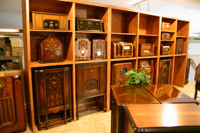

Yep. And they sell for less too. But not because they are less cool, or sound worse. They are a lot more work and take up floor space. I think that I have somewhere in the range of 35 consoles (6 in the house) and would have more if I had room to stack them - hum, there is an idea - -
P.S. Don't be lookin' at those empty shelves! I assure you that they are full now.
