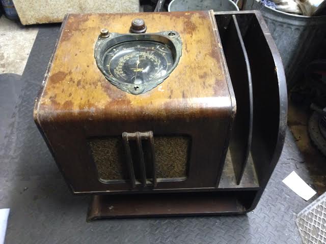

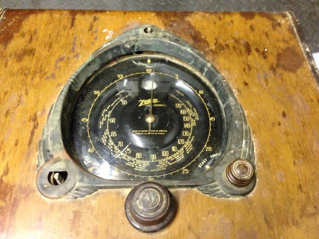

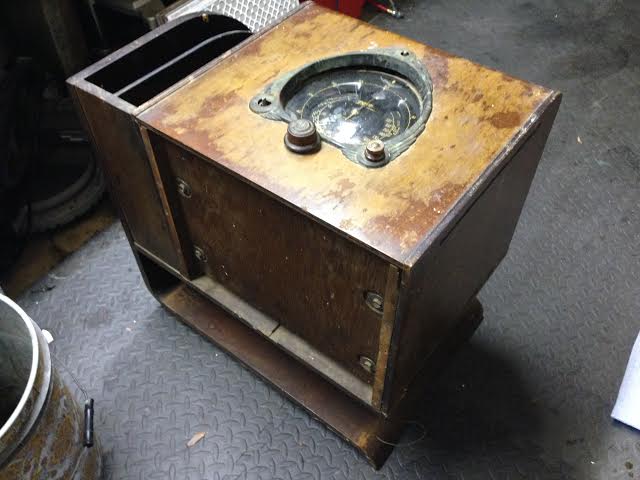

I had a good day so far. I got to the radio meet first, second car pulled in and he had a chairside in the back. It is in need of total restoration but I snagged it for more than I wanted to pay and traded some tubes. He loaded it and then it began to rain so not much else happened and I left. It is missing the back piece and 3 knobs. the 1 knob that is there is wrong I think. I believe I have the right knobs though. A few minor veneer repairs too. The face and the dials are perfect as far as I can see.

Z....dial looks good, though due to the angle and reflections cannot see 100%, same is the gass.

When I saw you bought one of course I had to look at some examples. Really beautiful cabinets all redone and finished. Im not seeing anything on the cabinet that strikes me as a royal pia. Gonna be really nice when done Ill bet...heck just stripping it will be 100% improvement. I know that's often the point where I can chill with a cabinet...when all the crud is gone and I can see everything.
Be careful taking the chassis out of the cabinet. Sometimes the speaker is in the way.
Another thing with those in console cabinets, when pulling chassis out the tone contol switch hits the ledge at the top and breaks.
In short, pull the chassis out slow, watch what's in the way.

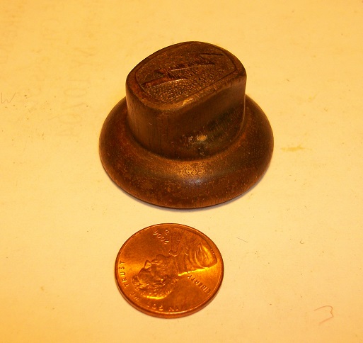

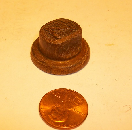

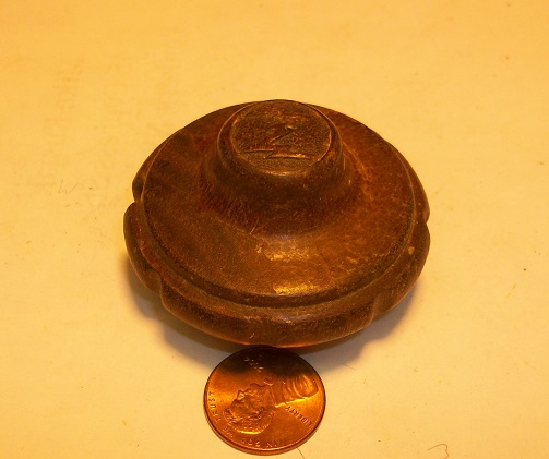

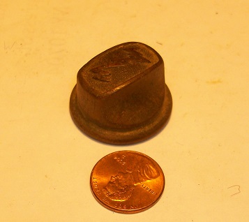

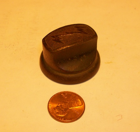

I'm not 100% certain of this but I believe that the chassis comes out of the side mounted to that sheet of plywood. It does not look like it could come out through the bottom like it would in most chairsides. The expensive part is going to be replacing those brand Z knobs with the "Z" carved into the center, most of the repro ones are made out of plastic so I'm sure you could come up with something better.
Exactly Mike!
I was pulling the chassis and it was very hard to get that one switch out. it actually scratched the inside of the cabinet while I slowly removed it.
It is a side mount and comes out sideways too.
As for the knobs, I got really lucky a while ago and got about 8 in a big lot of knobs. Hopefully the right ones. See pics, are one of these the correct ones? Is the one on the set original? I have seen it with the large flat one.
