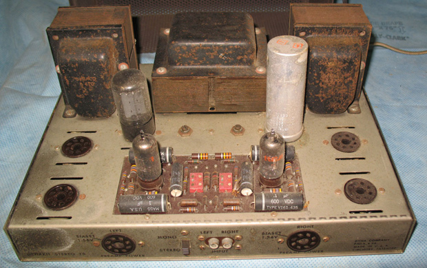

Here is the Dynakit Stereo-70 that I acquired recently. I am in the process of bringing it back to life. I spent time cleaning the chassis and removing a Rotron fan that had been added to the right side of the top cover, tightened the contacts in the output tube sockets, replaced the selenium bias rectifier with a 1N4006 silicon rectifier. Inspection showed that one output transformer was bad. A new transformer is on order from Heyboer Transformer Co. I have a selection of new resistors on order from Antique Electronic Supply. I have some film type capacitors on hand already to replace those. Bfrohwein gave me some used 6CA7s to use for a test. I just finished making circuit trace cuts and jumper wire connections to convert the OEM board to use 6GH8 tubes yesterday. I did a recheck to make sure I got the connections right. The cathode, signal grid and plate are the connections of the pentode section of the driver/inverter stage that change connection. I intend to order a power supply board from Joe Curcio to replace the can electrolytic with individual electrolytics. The rectifier tube could be changed to silicon rectifiers, but for now I think I will keep the tube.

You are lucky that the plating on the chassis is in good shape.
Are you going to run it with the cover off?

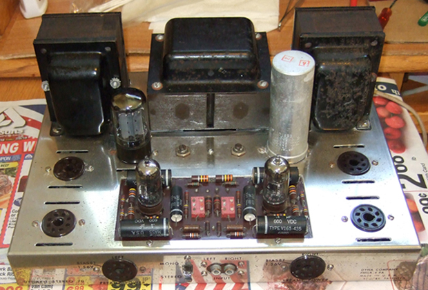

Phlogiston;
Yes, I like the looks of the unit without the top cover. The chassis does have a lot of small pits here and there and the bottom cover that wraps up over the left and right sides has even more plus some rust on the left side. However, if I want to, I can get an 18 gauge stainless steel new chassis with bottom cover for about $125 and after I get this unit going and checked out I might just go with a new chassis and use a star grounding system. I like to keep a watch on the output tubes just in case something begins to go wrong. I was lucky that the chassis cleaned and polished up as well as it did.
I just finished installing new 0.1mFd @ 630VDC polypropylene caps and also the .05mFd caps were replaced by .047mFd @ 630VDC polypropylene caps.

I have posted pictures of the restoration at: http://s1213.photobucket.com/user/rubal1...t=2&page=1
I did remove and paint the transformer bells. In the last pictures you can see the results of the painting effort. I used the "almost chrome" product from Krylon. The power transformer bell showed considerable rust on the inside. I sanded that to clean metal and then sprayed the inside with clear Krylon lacquer to protect the interior surface. The exterior of all the bells had to be sanded down to clean metal and then repainted. Most of the components on the PC board have been changed to new parts using metal film or carbon film resistors plus polypropylene capacitors. The PC board was modified to use 6GH8A driver/inverter tubes. I have replaced the AC fuse socket and installed a fresh 3A fuse. The AC switch was repaired. The Rotron fan was removed as was the top cover. A new output transformer is being made by Heyboer Transformer Co. Next step will be to replace the first two sections of the electrolytic can capacitor with new radial units under the chassis on terminal strips. two 100mFd @ 350VDC units X 2 will be stacked with equalizing resistors across them to bring capacitance to about 68mFd at over 600VDC both before and after the B+ choke. I will take some pictures of that parts install and details later.
