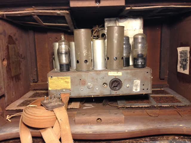

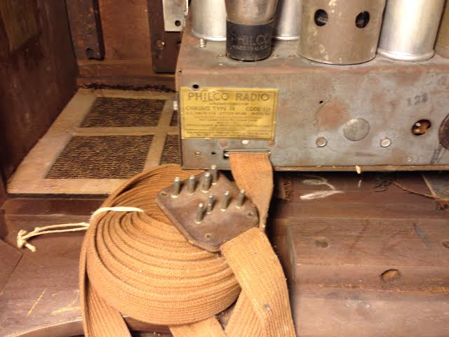

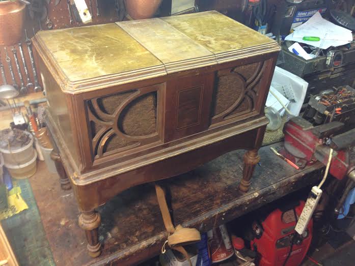

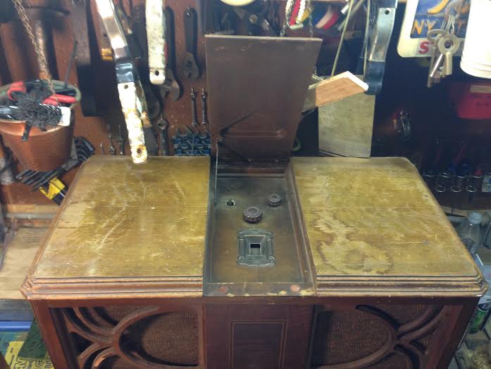

No built in speaker in my 19LZ Ugh
Please tell me this is a super rare radio so I can sell it and not have to look for a speaker Icon_lol
I thought it had the built in speaker but it is the one that needs the external speaker. How hard is something like this going to be to find?
The chassis says Model 19 and the Philco website has a photo of this one that need the external speaker but is it just that one speaker that will work with it in the photo?
Here are some pics:

I answered your questions here, but I'll repeat the info for you:
Quote:I hate to say this, but...good luck finding the original speaker cabinet. I used to own a 19TX, which is a small tabletop radio that uses the same separate speaker cabinet as the 19LZX. It literally took me 20 years between the time I bought the 19TX tabletop unit until I found the proper speaker cabinet.
And that flat cable is designed to plug into a box in back of the separate speaker cabinet. It should have eight pins; only seven of which are used in the 19LZX.
http://www.philcoradio.com/tech/lazyboy.htm
You could convert it to a 19LZ by mounting an 8 inch speaker inside the chairside cabinet, utilizing one of the grille openings. It is still a rare and not often seen radio, either way.
Icon_thumbup Icon_biggrin
I sort of wish I had kept my 19LZ, but I decided a few years ago that I had way too many radios...and it was one of the sets that did not make the cut, so to speak.
I think I would give strong consideration to converting your set to a 19LZ by adding an internal 8 inch speaker. It would not be difficult to cut a mounting board for the speaker, and mount it above and to the left of the chassis (while looking inside from underneath). I *think* this is where the speaker mounted in the 19LZ. There does not appear to be enough room to utilize any of the other three grille openings.

But then, I would not trust that flat cable after 81 years - this cable's conductors has the infamous rubber insulation. Icon_eek You would have to replace the cable...and you won't find a flat cable with conductors large enough to handle the voltages and currents involved...so you would have to settle for a round cable, which won't look original but will do the job.

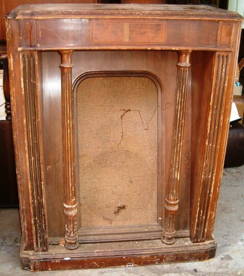

Would this be the right one. I have more pictures if you are interested. It is in Kansas and I would say rough shape but looks complete.
Let me know
Bingo, that's it. Icon_smile
Skip, do you know if this speaker came from a 19LZX/19TX or a 91RX? The only difference is the wiring inside the control box, which can be changed to suit either model.
No I have no idea. I just remember seeing this in a friends garage and he did not have any radio that matched it.
