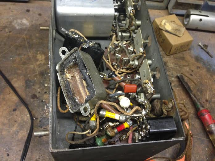

Ok I am getting back into these chassis and am lost with these resistors.
Reading resistors:
You can see the 3 resistors in the picture above. I know 2 are 490'000.00 and the other is 240'000.00 by looking at the schematic but how do you tell on the resistor? The 490K body is yellow and the end is white but no dot? Same for the 240K. red body, yellow end but no dot? Is there a different way to read them?

When the dot is the same color as the body, you can't see it.
Red body, yellow end, no dot would be 2.4K
