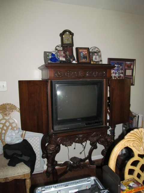

I am told that this was a hand made radio cabinet and given the my grandparents as a wedding gift in 1918. I remember seeing the radio as a child, but it has since been taken out and replaced with a tv. The cabinet is solid walnut and hand carved. I sure think it deserves a nice old vintage radio chassis with a large speaker but have no idea which one. Any suggestions would be appreciated.

But it does not have the front panel, or the chassis hoding shelf.
Unless those exist or are made, I do not see how a chassis can go in there.
As I remember, there was a front plate with some large black knobs and a large speaker opening covered with grill cloth. I guess I was just about five years old at the time. I imagine there was a shelf for the chaises. I don't remember a dial plate or lights.
As Morzh indicated, that is a drop dead lovely piece of work. If indeed was was a gift in 1918 I doubt at that time it had a radio in it. Not to say that it could not have had one sometime in the 20s added in the cabinet. After removal of the tV you might see some signs on the inside of a shelf as was mentioned that would hold a radio chassis and perhaps some sign of a front panel which would hold a speaker and holes for the radio controls and dial. That panel would have to be constructed for mounting what ever radio chassis (vintage) and speaker. It would take some skilled woodworking to make this and have it look right when the doors are opened. Well worth the effort if you like old radios. As it is it certainly is a nice accent piece for a house, hiding a TV.

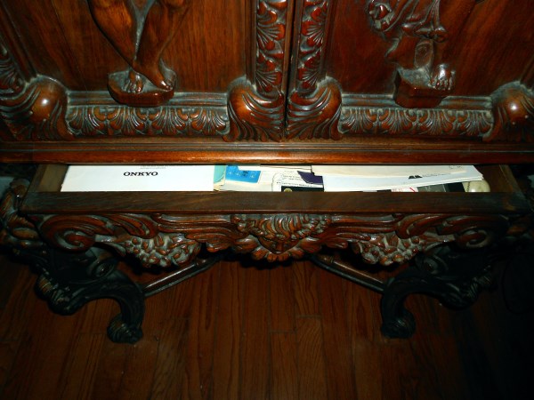

Thanks for the response. By the way there is a hidden drawer just below the doors.

I would get rid of the 80's vintage TV in it for a start, and have a look on the inside for what may have been fitted in there such as mounting blocks or screw holes. Yes, see if you can find any photos of it with the radio inside with the doors open, that will help narrow it down if you want an exact match for what went in there.

a peek in that secret drawer would be nice too.

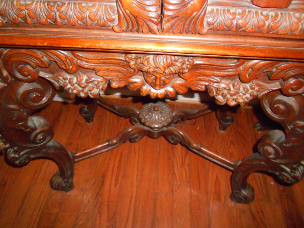

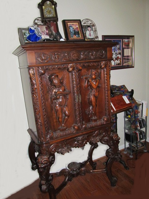

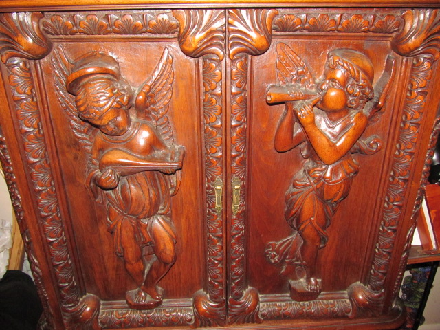

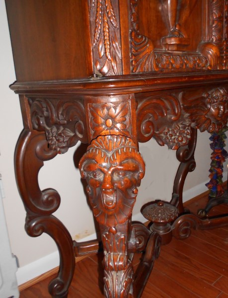

Thanks. Here are a few more pictures of the radio cabinet
Beautiful carvings...
With a hidden drawer, I wonder if it started out as a writing desk. Old secretaries with pull out writing tables would have secret/hidden compartments like that. Maybe it was gutted and used as a radio cabinet later? Are there any signs of shelves/compartments toward the top of the inside like light wood lines or dow pin holes?
Wow!  Ain't dat sumpin?! Icon_razz
sorry just too spooky looking Icon_eek
