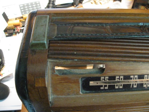

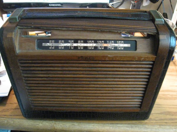

Can someone please tell me what the metal strap holders where plated with.

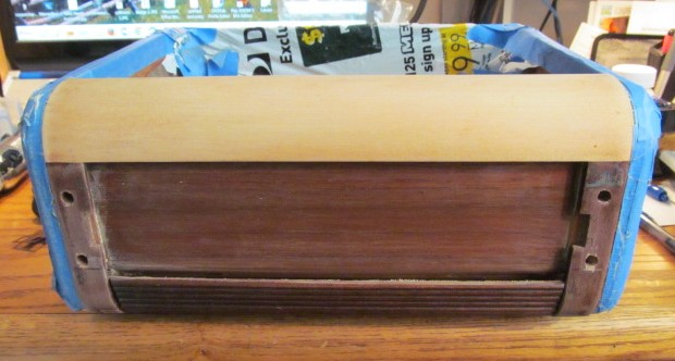

Also it appers that the wood used for the cabinet was walnut, however it appears that a curved piece of pine was used on the rear top. Can you tell me what the original cabinet was stained with? Were there 2 different stains used?
Mine looks to be copper or copper plated.
Thanks for the information. Has anyone tried those small parts plating kits? Or maybe there is someone who specializes in plating small parts at a reasonable price. One more question what are the feet made of. They look like tacks.
Look on utube for safe and easy home copper and nickel electroplating, (guy copper plates a quarter and nickel plates a penny) videos look like it will produce nice results on small parts.

I have two similar sets, but they are the 1946 versions, and the hardware was copper painted near as I can tell, not plated. Even if they were plated I would not go to the trouble or expense of having that redone, these sets are very common, Philco literally built 100s of thousands of them so it would not be hard to find a better example. The wooden parts are maple or some other blond hardwood, not walnut, it could also have been beech or birch.
Agree, I've rescued a few '46 and '49 sets. Some had leatherette sides, and cabinet wood was all over the place, and the straps are almost always bad. I'f taken to removing straps and filling in cabinet top, removing leatherette and use tinted laquer to get everything looking the same. The leatherette backs are usually OK and just get wiped off. I also removed the troublesome AV/Battery switch an all the other battery stuff (don't expect anyone would want to rig up batteries and haul the set around.) But you can make a new handle from an old belt you had when you were skinny, yup, paint the metal clips copper or nickel color as you wish. Don't forget to dumb down the power supply at the last leg (filament supply) of the voltage divider to be correct for the string, definitely a must if you replace the rectifier with a diode.

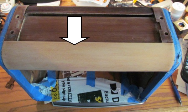

Looks like it is going to be a great weekend here for finishing my 49-609 cabinet restoration. I still need to know if this model was stained in two different colors. The curved wood is very light compared to the rest of the cabinet. Can someone please tell me if this is true and what the colors would have been?
Hey,
From research I see a few different finishes. The most prevalent is extra dark walnut or black on the outside, perfect brown on the trim and a lite coat of medium walnut for the face and back curve. you could probably stain the face and curve as they will darken a bit when clear is applied.
From the outside to the inside it is dark to medium to light.
I don't own one but thats the colors I would use.
Im sure someone here will know exactly what is needed.
Kirk
The wood on that one looks more of a medium walnut colour, though I don't know why. Both of my 46-350s used a blond hardwood, probably maple or poplar, and it was all consistently yellowish like a hardwood floor. What happened with yours I don't know, probably the cabinet shop used whatever wood they had laying around and didn't worry about matching species or colour too closely.
