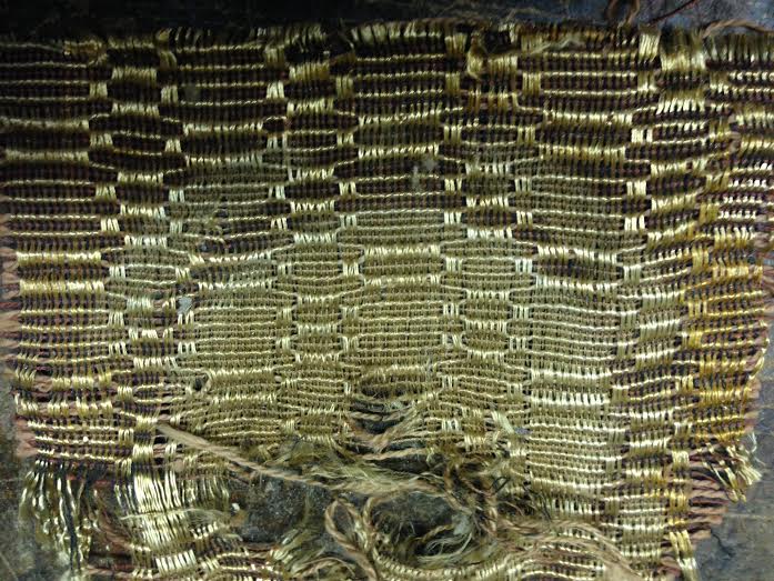

Hi Folks.
Has anybody ever seen this Grille Cloth used in a Philco in the USA.?
What was it from?
Eric

That does not look like any USA Philco cloth pattern that I have ever seen...
Oh, since this topic is about grille cloth, which is associated with cabinet restoration, I have moved it to Philco Cabinet Restoration.
Hi Ron.
It is off the Philco 98 series 2 (export) we discussed a while back.
I am about to update that post with a new development.
I have just acquired another 98. this time a series 1.
Both cabinets are the same apart from the through front stud bolts on the series 1.
At This stage I am concluding that the cabinets were made in the UK.
The grill Cloth is exactly the same in both the 98 series 1 and 2.
So I am thinking that if the grille cloth is absent from the US . That is another indicator for UK manufacture of the cabinets.

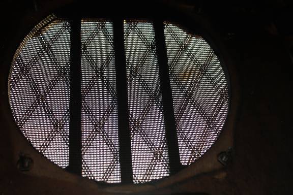

I would have expected the cloth in your 98B sets to look like the cloth in this 2620 I used to own:
[Image: http://www.philcoradio.com/world/images/2620b.jpg]
I've seen photos of several different UK Philcos that used that cloth pattern. Like the one you posted a photo of, this cloth was also never used in USA models.

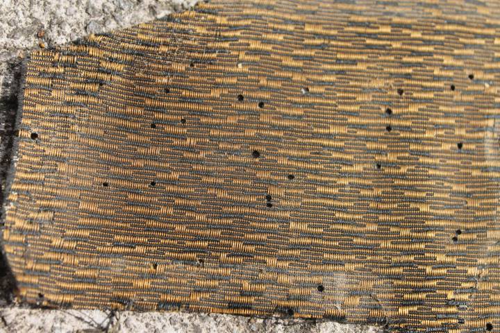

Edit: I just found it. The lines are much smaller than that used in the 2620 cloth, and the overall pattern is different, yet reminiscent of the original. (Maybe if the cloth were reversed?) Bret Menassa (Bret's Old Radios) is the seller. He does not currently list any of this pattern on eBay, but is selling a sample pack that includes it - the photo you first see in this ad is the cloth I am referring to:
http://cgi.ebay.com/300846538820
The grille cloth in that first picture, the one with the insect holes, looks like a type of grillecloth that I have seen in RCA sets, at least Canadian RCA sets.
Looks like my zenith cloth
That "weave" looks very similar right enough. In the back of my mind I am convinced that I have also seen the cloth used by philco in my photo on later amplifiers. I recall it in a green, silver and the above bronze colour.
I also recall that philco 2620 sporting the chevron patern cloth.

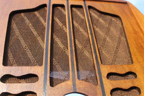

Attached is the pattern I have fitted.
It is original early 1950s material Not Philco, "Murphy" I think.
Hope this is not an abomination to you wonderful philcophiles.
I will replace it if I ever come across the original pattern. "PROMISE"

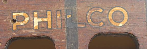

Attached a close up of the Decal, identical on both my cabinets and the ones I have Which as can be seen are somewhat different.
I am probably going over old ground here I suspect Ron.
Regards.
Willie.
