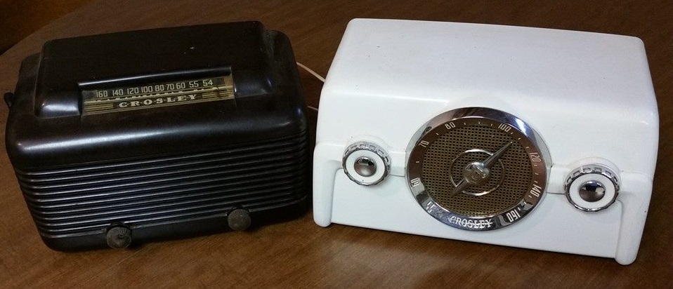

It's huge, with around 3,100 swap vendor spaces. As such, not everything is solely devoted to classic car parts. Every other vendor was a tool vendor it seems. So I was surprised to come across a vendor with about a half dozen plastic cabinet radios for sale! I picked up these two little Crosley's for $85, which I didn't think was too bad. The white one is worth that alone (a model 10-135 from 1950). But the other set is a mystery to me, as the model number tag on the bottom is half gone. Unlike on a Philco, there is no model number on the backside of the chassis either. I haven't had a chance to take the chassis out of the cabinet to see which tubes are used, but it is a standard run of the mill AA5. So, since it seems to be a fairly common one, I thought I'd post a picture to see if anyone can ID it?
I'd just like an idea of the model number to try to locate a schematic. If no one knows, when I get a chance I'll take the chassis out of the cabinet and take a picture of it, and list the tubes used.

I believe it is a 56 TU but no handle?

Thanks, yes I was able to ID the white one, it's the dark colored (brown) one I am puzzled by. Kirk, this one evidently never had a handle, as there are no tell-tale holes in the top of the cabinet. Also, this one has a reverse dial. Meaning it goes from (left to right) the high end of the band to the low end, instead of the (more common) other way around.

I found this one online, and, in comparing pictures, it does have the same dial face. I think 56 TU is probably it, just that it doesn't have the handle on top. http://www.ebay.com/itm/251655043457

can you peak inside top
maybe was covered over ?
some one swap chassis ?

OK, Just took a minute to pull the chassis. It is indeed the 56TU, as it uses the exact same tubes shown on the Nostalgia Air schematic for the set. BUT, it has no holes, no anything on top of the cabinet. And, looking at the listing for the set on Radio Museum http://www.radiomuseum.org/r/crosley_56tu.html it says "Tablemodel, Mantel/Midget/Compact up to 14" width, but not a Portable (See power data. Sometimes with handle but for mains only)". Not sure what 'for mains only' means, but evidently some came with a handle and some without.

Look like they are in good shape, I like the brown one, very typical of the time.

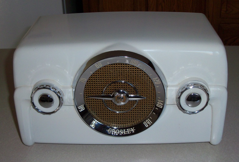

I spent the afternoon recapping the white one and polishing up the cabinet. Turned out rather well I thought. It plays remarkably strong and sensitive for a little AA5. Here's an "after" pic...
