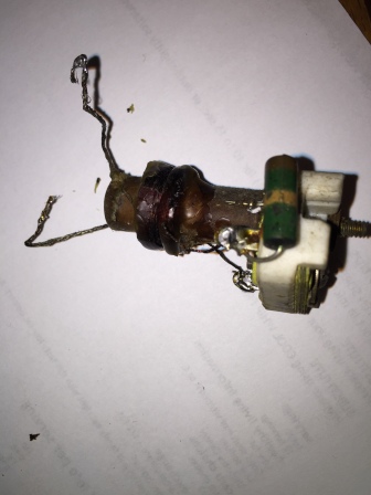

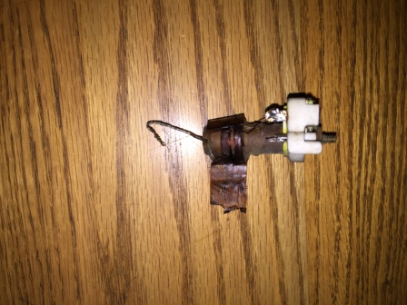

I took the coil out of the chassis and heated the wax paper covering with the soldering iron to get it to come off. The connections at the coil were good but it looks like the side of the coil had been nicked or maybe burnt. Its hard to tell without a magnifying glass. The nicked spot is darker than the rest of the coil and it feels rough or prickly like the end of a wire. I don't think I can fix it so I need a replacement if anyone has one they want to sell.
