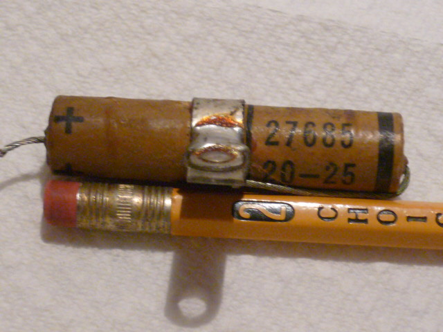

Here is a picture of what I call a paper cap I have never seen anything like this in my very limited experience which is why I'm questioning it I do not believe it is a electrolytic cap so what is it? The position of the cap I verified both by the wiring diagram and the schematic.
Eric
That's an electrolytic cap. At one time they were made like that in cardboard tubes. Note the + symbol at the left end in the photo.
Just never saw one like that, also the braided leads were quite different.
Thanks all
 Two .01 uf 630 vdc caps is .005 uf 1260 vdc in series, I take it this one is a tone compensation cap across the output transformer primary? The electrolytic is probably a bypass connected in parallel with the bias resistor on the audio output tube, if so then 22 uf at 20 vdc is fine, in fact you could use pretty much anything there if it's at least 20 vdc, 20 volts is sort of an odd voltage rating for a small electrolytic anyhow, sort of like finding a 1/3 watt resistor.
