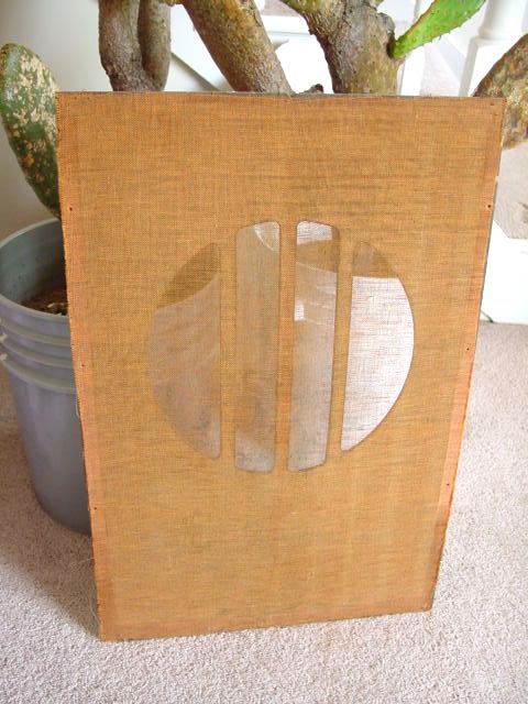

I seen that the cloth covering the speaker was a kind of gauze or cheesecloth type of material. It was evenly spaced threads, and dyed a reddish brown color.
I tried to take a photo just now, and you can see how much of the cloth is visible. Not much. Stand back from your set. You can see that not much of the speaker board can be seen.

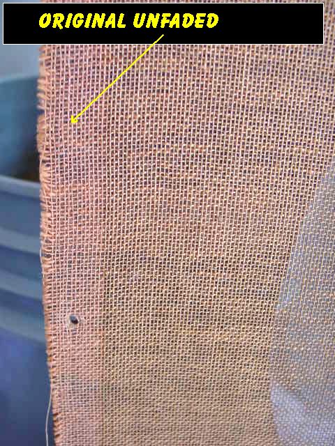

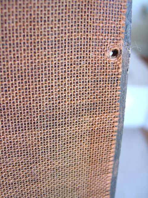

Curiosity got the best of me today, and I removed the speakerboard. You can see that this is the original cloth mesh. The unfaded parts were protected by the cabinet, so this is the true color.
Of course, the other exposed parts have faded somewhat.
There is no pattern other than what is seen in the photos.
So, it's up to you what you want, but if I had to do mine again, I'd use the mesh stuff as original.
Hope thse new photos help you decide, the others were hard to see between the grillebars.

Jerm, patterns 61 and 62 are wrong for your set. While Pattern 12 would be OK, I have to agree with Gary that a plain, open weave, light brown mesh cloth is what you really need. As an added bonus, something from the fabric store will generally be much cheaper than custom-manufactured reproduction grille cloth. Icon_biggrin
