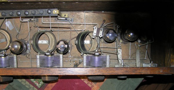

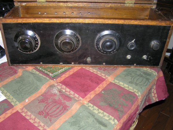

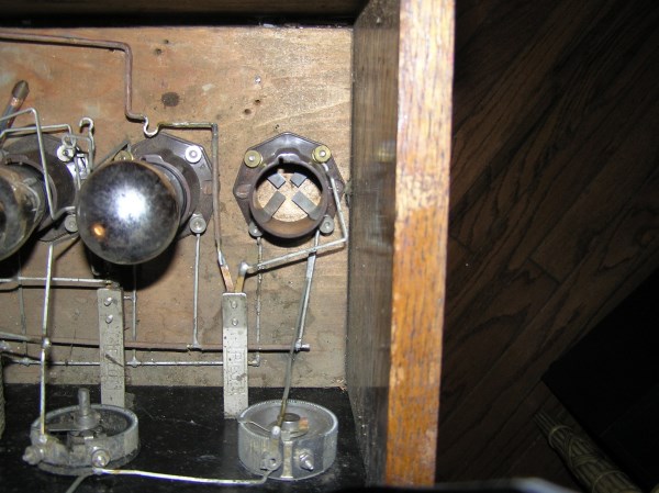

I picked up this set the other day, but I don't see a model number anywhere.  Also is a schematic available and as you can see one tube is missing.  Can someone tell me what number it is?
Looks like a Crosley. But then Crosley usually had the logo at the front.
it is a neutrodyne, I think. Hazeltine? Fada?
It appears to be a homebrew trf set. If it were a production set the bus wire would be straighter and neater, also the rheostats would probably match. The missing tube should be an 01a or a 112a if it is the output tube but either tube will work.
More than likely the audio transformers are open.
On closer inspection, it looks like the transformers have been removed.
