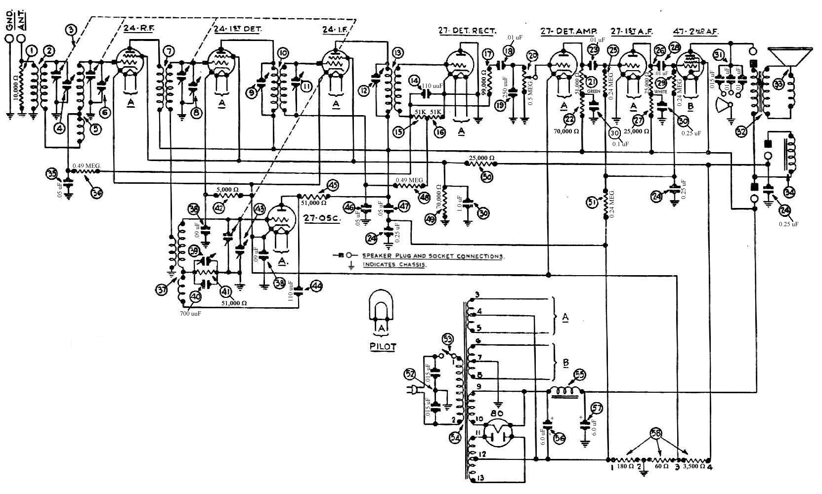

Please, show the link to the sch and the position number, part number by itself (or whatever it is) is not informative.
Here is the schematic.  The three capacitors are labeled "30." They are presently housed in a metal case condenser.
Link to metal case condenser product information: http://www.philcorepairbench.com/metalcap.htm
Link to information on Model 90 metal case condensers 03325 and 03327: http://www.philcoradio.com/tech/90error.htm
All three are OK if 500V and up rated.
Thanks. How about the electrolytic capacitors - #56 and #57? They're both 6µf. The data sheet says they're rated at 400v. I've read lots of posts that say that electrolytic capacitors from Philcos from that era should be replaced with 500v capacitors, because 450v may not be enough.
Well....I always thought 450V would be enough but for about 2 seconds the voltage makes an excursion into 475-480V at which point the tubes start conducting and it drops down to about 300V.
So, yes - 500V rating takes all those questions off your mind.
