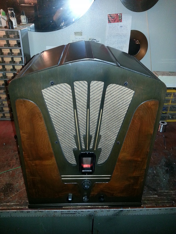

Philco 16b is alive!
     This cabinet has had been salvaged , and I must say rather well Icon_wave

Excellent job Fred!
You've sure been busy Fred!!! Great job.
