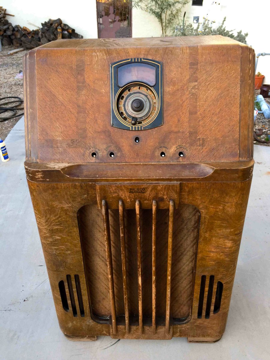

So. I just bought a Philco 38-116 off of Craigslist for $80, I always thought these looked really awesome and figured I would buy one some day and refinish it and just put in modern electronics and hook up to my computer/phone via bluetooth or wireless.(please don't put me in a cage of gasoline and light me on fire)  I am okay at woodworking so I feel confident I can get the case looking nice and it's not really in very bad shape at all.  I have posted a link to all of pictures here:
https://www.flickr.com/photos/58236519@N...585628966/
I am just figuring out that there is a big community of radio restorers so I wanted to figure out what I would be getting myself into if I actually wanted to restore the guts as well.  Keep in mind I'm and engineer so it will probably take me twice as long as a normal human.  So, for a complete newbie is it even realistic to be able to restore the electronics, how long in hours should I expect to be able to complete this, and what would be the best case and worst case on getting it up and running again.  Also, compared to modern speakers how well do they actually sound, I am worried about spending lots of time and money to restore the electronics and then not ending up very happy with it.  I have a small FM transmitter device that I can hook up to my phone/computer and transmit FM so I would be able to pick it up on the console radio, just not sure how good it would sound.
I am not a purist here and new to this so I am not really opposed to just pulling everything out and putting in something modern and easy. (do they sell premade kits for this)  That being said... I have no idea about the models, their rarity, or overall historical value.  If this radio happens to be a particularly rare & expensive model then I would spend more time considering a full restore, but if you guys tell me that these are a dime a dozen then I might lean more towards new insides if it is something that would be very difficult to fix on my own.
Just curious what the experts say on this and also wondering if the $80 I spent was too high.
Be gentle I'm new.

  The 38-116 was the near top of the line set in terms of the 1938 Philco lineup, whilst they are not rare as hens teeth they are also not exactly a run of the mill set. These sets were among the best sounding radios of that era, even though they were AM they had a feature known as varaible IF bandwidth, they also have automatic frequency control circuitry which Philco called "Magnetic Tuning". They also have five bands, a shadowgraph tuning indicator, a push pull power output stage using a pair of 6L6s, and 15 tubes, so it's like having a communications set with a high fidelity audio output stage attached. From what I can see from the back it looks fairly complete, the speaker and acoustical resonators are in place, and the chassis looks rust free with most if not all of the tube shields intact. I don't know if you have the knobs but those can be found, the finish on the cabinet is bad but the veneer looks reasonably sound other then a few places where it is lifting. I've never restored a 38-116 myself but many other on here have and can tell you what needs to be dealt with, they are not the easiest radios to work on but usually well worth it.
  I should add that if you still want a console cabinet to put some modern Chinese consumer electronic junk in there are plenty of empty cabinets to be found, at one of the swap meets they even have a bonfire at the end to dispose of the really ratty ones. If you want one I'm sure someone on here could supply you with one at little or no cost, but a 38-116 is just too good of a radio to act as a donor for that purpose.

Welcome! You now own one of Philco's finest radios. It will not receive FM but will receive AM and shortwave with amazing fidelity. Should you decide to pursue restoration of it yourself, keep in mind that this is a complicated 15-tube radio and will not be easy for a beginner to restore. I have had two or three of these sets cross my bench over the years, and I've always been impressed with them. If you successfully restore this set, it will reward you with superior performance. You could even make a slight modification by adding a phono input jack which you can use for an iPod or even a Bluetooth adapter.

No, you did not pay too much. 38-116 sets routinely sell for $300 or more in good condition. Yours, as is, is probably worth about half that - which is still almost double what you paid for it.

Welcome to the Phorum!!  Wow, great find!! +1 on what Ron and Arran said. The cabinets of the period were finished with toning lacquers and clear nitro cellulose lacquer.  Lots of discussion of that in the cabinet section.
Yes, great find, good price, no, not the best first project for a novice but then maybe you are not a novice. For someone green behind the ears it might be a bit intimidating, and even for someone more experienced who never tackled a big radio before it sure does look imposing.
The solution is as always, eat an elephant a bite at a time, do not try to imagine the whole project's scope, just start and keep going. It is not a job, there are no deadlines, might as well make it a learning thing and enjoy the ride.
Unless there is someone at your household to object to a big wooden ugly thing, I recommend starting with the chassis, as when you finish it and it sings, you will have a significant endorphine boost when it happens. Then you can tackle the cabinet knowing for sure it has a good radio to go in it.

At  first  glance it looks like someone has been playing musical chairs  w/the  tubes along the back.
Good buy at $80.
Bill, some very nice pictures. I hope Sam sees them as the bezel is in very nice shape to use as a model for one that is lacking paint.
Jerry
And the dial glass is intact.

Overall based on what I've seen others accomplish with much worse, it seems to be in pretty good shape considering the years. So I started cleaning the cabinet down with Goop last night and man that stuff is working like a charm, tons of thick back gunk coming off and she is beautiful, tempting just to rub in some oil and leave her like that but much of the finish is flaking in places so I think it will need stripped and repaired in places. i plan on working on cleaning, stripping, repairing wood and fiddling/cleaning mechanical things on the chassis until I figure out next steps on electronics. Any good recommendations on books on basic design and function of tube radios and also steps to troubleshoot and repair them?

Forgot to mention regarding the dial. That looks to be more or less the original color. Also, do not use water if you try to clean the dial. The paint (ink?) on there is water soluble.
