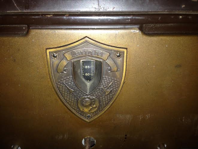

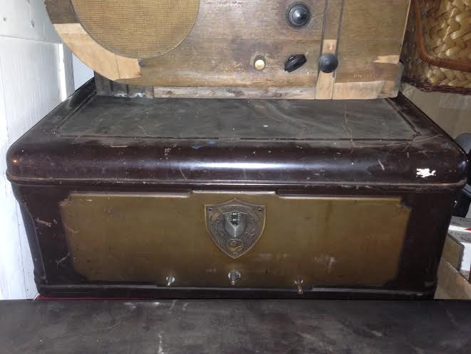

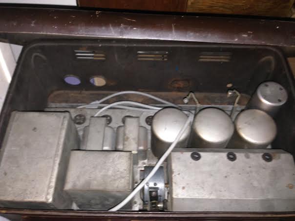

I received a wonderful SG-8 Knight radio from Sam last year and have finally gotten it out.
I would love to get a speaker for it but cant find anything online on what speaker to use.
any ideas??
Here is a pic since none exist online:

I've got one also. I think it uses P/P 45's in the output stage. You will need to a real speaker not one that is make for a battery set. What I was going to do is grab a RCA 100? The big metal drum speaker gut it and mount a PM speaker with an output transformer. Don't remember if it needs a field coil/choke.

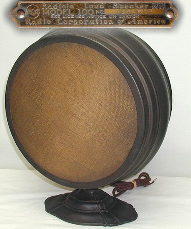

Sorry I missed your post about speaker. Here is a pic of the Radiola 100 spkr.
 http://www.radiolaguy.com/images/Radiola...laSpkr.jpg
Typically they go for pretty cheap $10-20. Or you could use a Philco G or H
spkr. It has the FC and output transformer all ready on it. If you would like I
could make you up spkr,output trans,and choke to be fitted into the 100 cabinet

And the toobs you are looking for are 3 #224 or 24A's, 2#227 or 27''s, 2#245
or 45's, and 1#280 or 80 toob.
