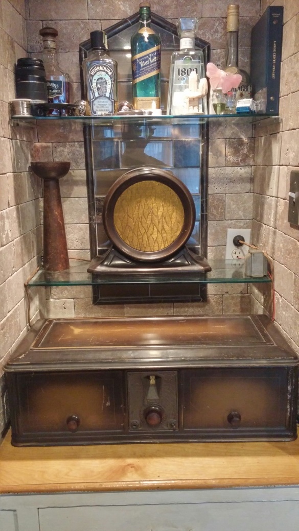

Thanks again guys....the output transformer is in and it actually sounds better than my philco 90 or 111 with a 15 ft antenna....original speaker too!
Nice setup.
What is this transformer right of the speaker?
Looks Goood.
That's the dead transformer. Ironic as it is, it seems that one of my coils may have gone open in my 90 yesterday as the music keeps cutting out for a few minutes at a time. I only rewound the one open coil when I restored it...knew that decision would come back to bite me in the butt. Back to the 90 again.
