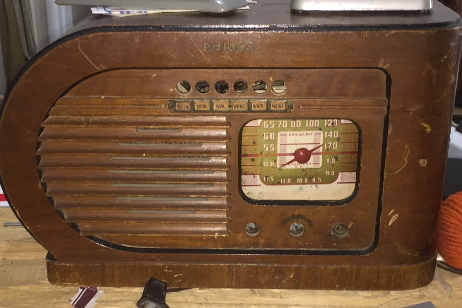

This Philco was working great a year and a half ago, but everybody said I needed to recap it. They didn't take into consideration that I had not the foggiest idea how to go about doing so. I botched this poor radio up pretty badly.

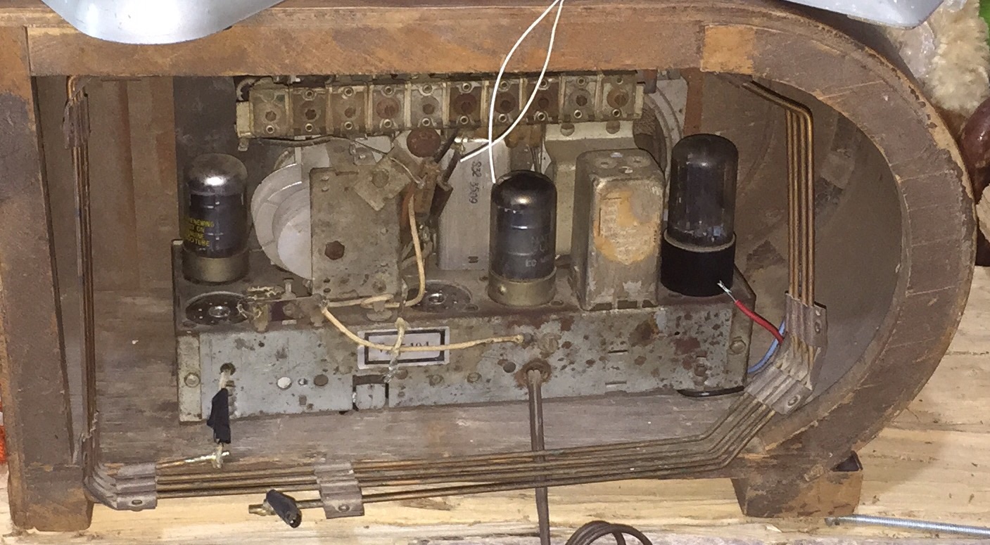

Here's the bad part.
Slave to an RCA Victor CTC-25

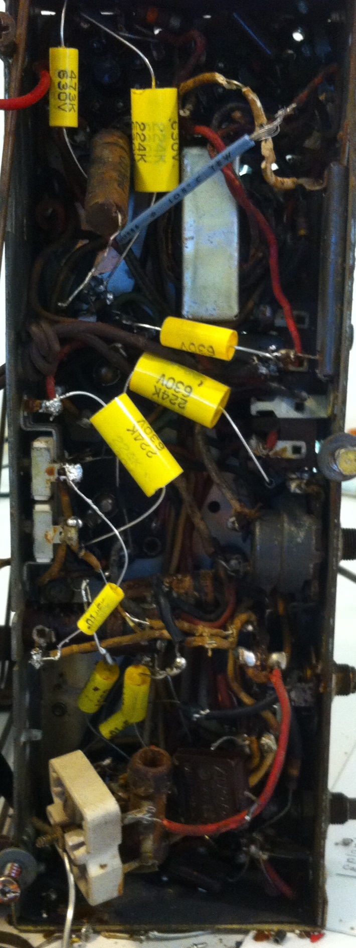

Here's the really disturbing part. This picture was taken on my old iPhone 4 right after I performed surgery. As soon as I turned it on, the magic smoke came out. Loudly.
Looks like you didn't change all the capacitors. Also, you might use a little more heat when soldering the solders look a little cold. Everyone was right when they said you should recap it, if not the magic smoke would have escaped sooner or later. I would look for shorts and make sure you put the caps in correctly and replace all the wax and paper caps. Since it worked before there must be a short for it to do this, I would think. Good Luck.
Yep. Sorry to tell you that, but it is a bad recapping job.
Also, this missing insulation on wires, like that one going to the Candohm resistor - was it like this before? Does not seem burnt. If it was, why did you leave it be and not replace it?
These long caps' leads that can short any moment do not help either.
When you recap a working radio, you could take pictures, many, with good detail so you could see how it was before so if you need to go back and look.
Soldering should look neat - use appropriate temperature and flux, so it flows, not smears. Looks smeared.
Old tubular capacitors had thicker leads and longer bodies so the bare wires did not run long and did not bend easily, and any longer than safe bare run lead would be insulated.
Better luck next time.
