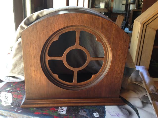

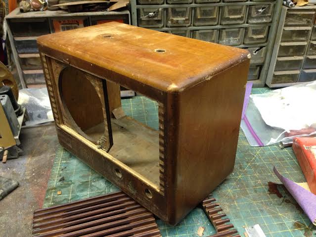

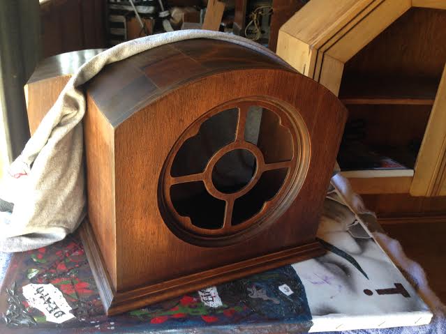

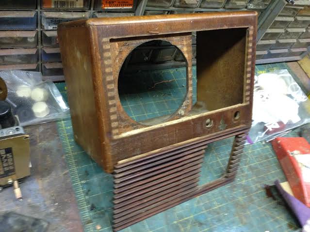

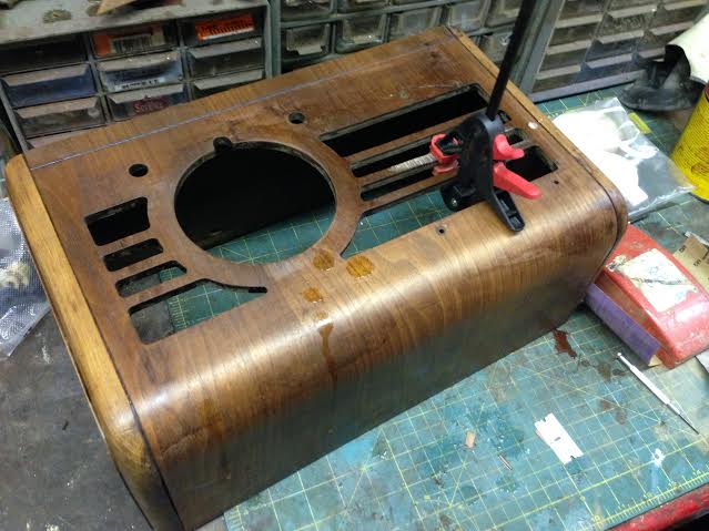

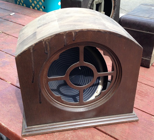

So nice out that I decided to spend the morning repairing, Stripping and cleaning a few pieces.
I have started on these 3 since they were on top of the pile Icon_lol

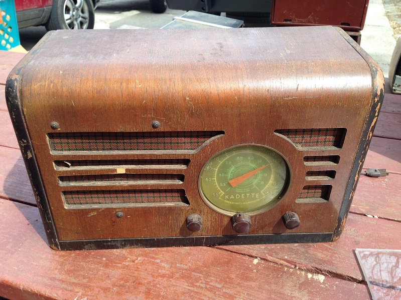

I have repaired the grill on the Kadette so far.
I finishd the horrible job someone did trying to strip the speaker.

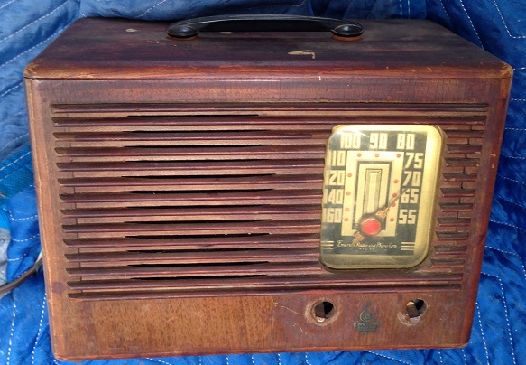

Last, I had to strip Nasty! poly off the Emerson.
I need a new spring for one side of the handle too. Might have to make one.
Fast! Speaker shows promise!

Kirk;
I have an example of that same model of Kadette you are working on, the knobs are correct on your set but the dial pointer is wrong. I seem to remember the one in mine being white and thin like a needle, possibly with a crescent moon on the end. It's another set on my bottomless pile of sets to restore, and it, like yours, needs the celluloid lens over the dial replaced, it's fogged up due to hairline cracks. It's an interesting set electrically too, it has a pair of #43 output tubes connected in parallel, plates and grids tied together, filaments are in series, and I think it has two glass ballast tubes.
