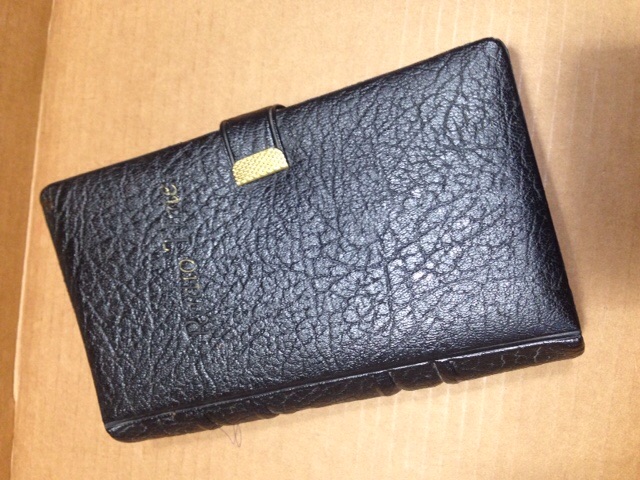

I am not into transistor radios but I did get one recently that I really like.
My library is themed for secret compartments. Saw this secret hidden radio in a book and bought it instantly. Cover says radio time, it is leatherette and even has a clock in it! We know how I love clock radios. : mrgreen:
